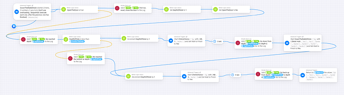

Hmmm, does that mean I can use triggered flows recursively (ending the recursion using a stop condition, often based on returned results) - does it? Can I “nest” multiple self-executions?
Yeah i think so, but make sure it is not executed 60 times, else you will have the same flow running actively 60 times and homey will kill it and disable the flow.
Do you think this will work?
I am kind of afraid to start it :nauseated_face:…
Okay, tested it and I find it very interesting.
It looks like the last triggered flow at the bottom executed, including its tail that comes back up a depth, but it is not actually returning to the place of the then card in the parent flow, at least, the tail of that (with the next resurface, and the return to the grandparent) does not seem to be triggered, at least I am getting no log messages beyond the first return.
Maybe those flows all have the same ID, and the return closes all of them. Or maybe the return just doesn’t know how to jump back to a triggered advanced flow - even if it is the one that launched it. I don’t know.
Also, performance really, really bogs down when I run this - or at least, the flows either do not run at speed or they do not run consecutively. Those last two digits in the timestamps are minutes.
I don’t think I tripped any unintentional endless recursion, I don’t think. It could be some performance issue that stops the flow from returning, but it happened the same way at depth 6.
Anyone have any idea what is going on here? Why not return, and why the slow-down?
Here is a copy of the latest flow I used.
I’m still really interested in this. Anyone?
You dont have anything filled in the return values card.
No idea about the slowdown, the cards are made to be triggered very fast.
