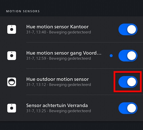

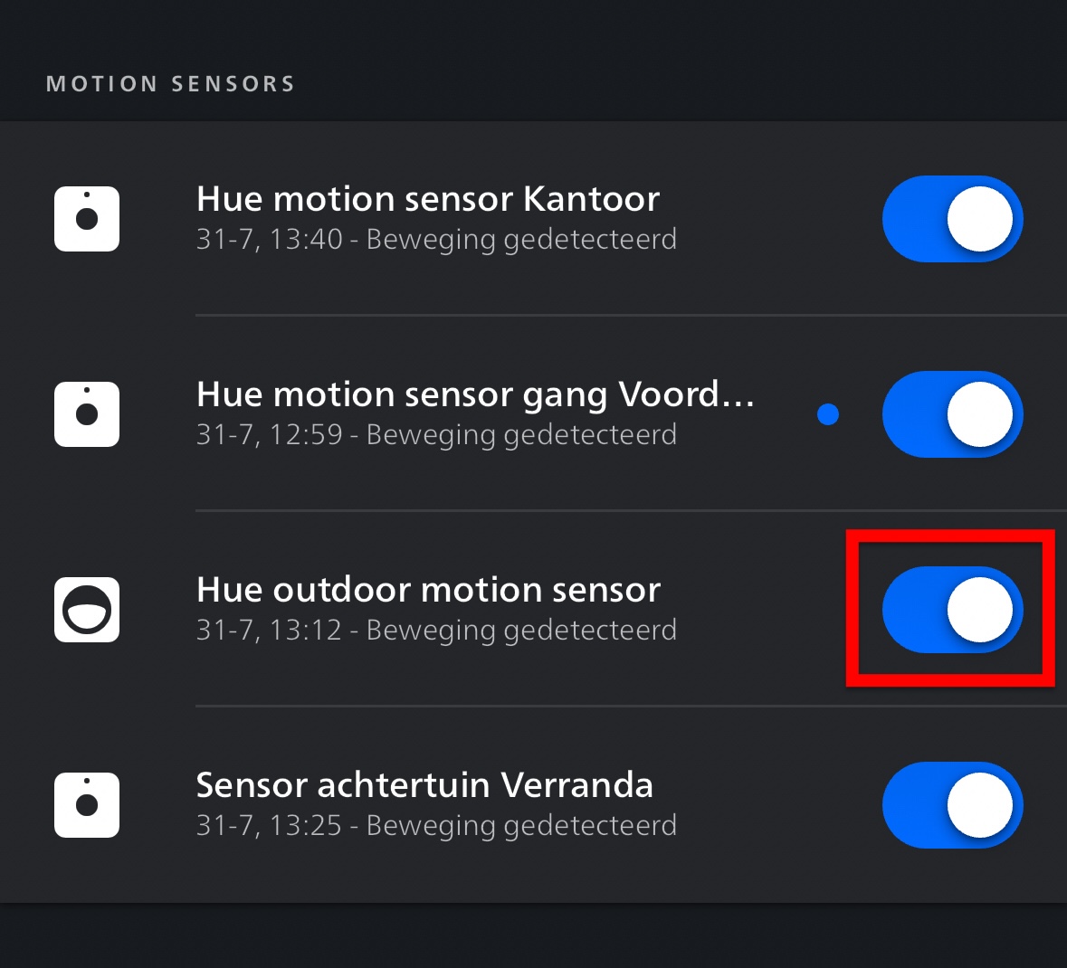

Any way to ‘disable’ or ‘enable’ a sensor from Homey, so it’s visible in the Hue app?
Basically just toggling this in the Hue accessory list.
It is possible to disable and enable a sensor in a flow. This has, for me anyway, been reflected in Hue app

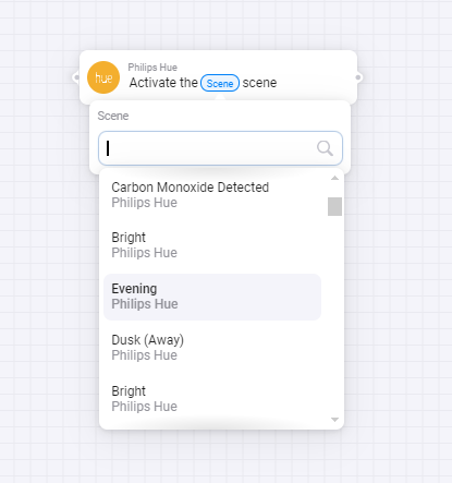

Does anyone know if its possible to see what room the scene exists in when using the flow card to activate a scene? I know I can rename them but my enviroment was built first and used for voice control in some rooms so preference is not to re-word them.
The issue is if you have a scene with same name in different rooms like example below, you don’t know which one is which. Am I missing something? if not it would be useful to add the room name as a prefix in the drop down list as part of the Hue App.
Had the same problem and I just name the scenes in Hue so that they are easier to identify in Homey and other home automation systems.
I figured that might be my only option - thanks for the update.

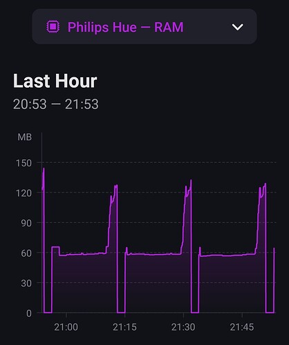

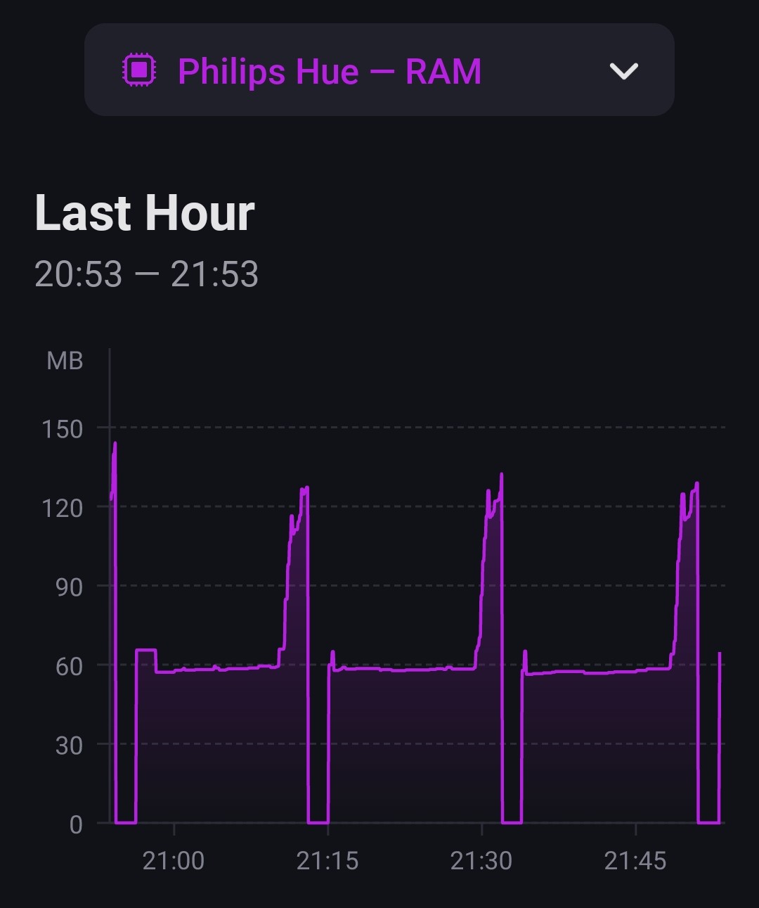

Same thing here. App starts to consume masses of RAM every 19 minutes and then crashes. It is so predictable you can predict the time exactly when it will crash next time. App Insights below. Crazy.
