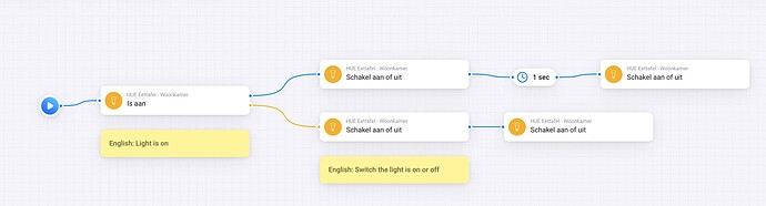

Hi! I see that the single blink, which is greatly missed, has been extensively discussed above. I have the same issue. I used to rely on it as a check to ensure that I had set my alarm via Homey. It’s reassuring to know that it worked and that Homey isn’t down. Nowadays, you get a mini disco, and after two blinks, you think: the message is clear.
I have a solution. I still need to test it extensively in practice, but it seems to work well in my initial tests. In the flow where you previously had the blink card, now set "Start [flow]:‘’. Create the following advanced flow. (See screenshot) When you start this, a blink will occur.
