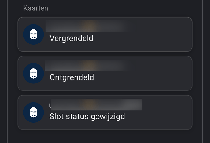

Could you make a printscreen of you When cards, so i can match my setup to yours? Thanks!
This is a “When”-card
It’s just a tip I didn’t ment it as an insult but ok, i had a lot of f ups with apps that had auto updates on and decided that i want to read the changelogs first before updating.
Yes i know. But i need a printscreen of all available When cards so i know what options your lock has.
Ah sorry, this should be it
