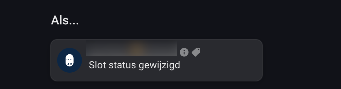

I’m now on 3.4.1 … that was automaticly updated.
Today i’ve noticed that a flow isn’t working anymore … and when i talked to people in my house they confirmed it too.
It has something todo with this
But which version were you on before? The live version or the Test version?
And about the When card: Is it not triggered anymore?
Could you describe the issue, so i can simulate and solve it?
And, could you share a printscreen of all your When cards for this lock? (it gives me insights into how the device is configured).
How can i see / find out?
As far as my knowledge goes i wasn’t on a test–version.
The "Als’-card isn’t triggered anymore, and it was before when the status changed …
btw: I also don’'t get updates from the lock into my homey, whereas before i did get them ( when someone (un-)locked the door for example )
