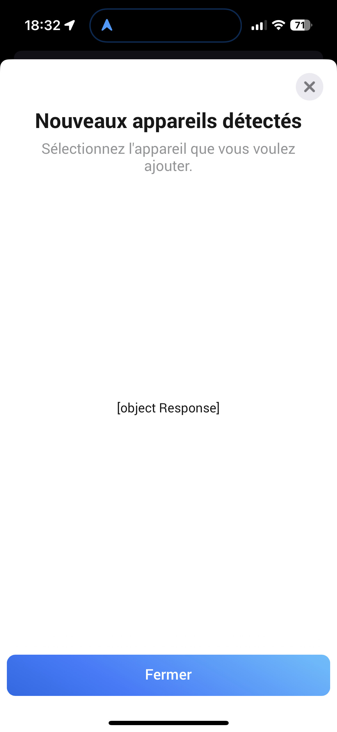

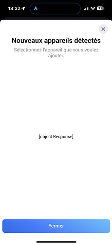

H6052: Aura Table Lamp:
Installed and all well for a little while. Created a flow to have the lamp change color, and get (object response).
9ac3e0dd-d09b-477d-a8f6-42d80182bbb5
Update: Fixed after restart of Homey
I looked at the log and also could not find a error in the log itself. Intereseting error anyway. Happy that it got fixed by restarting Homey. Lets consider it a fluke for now ![]()
