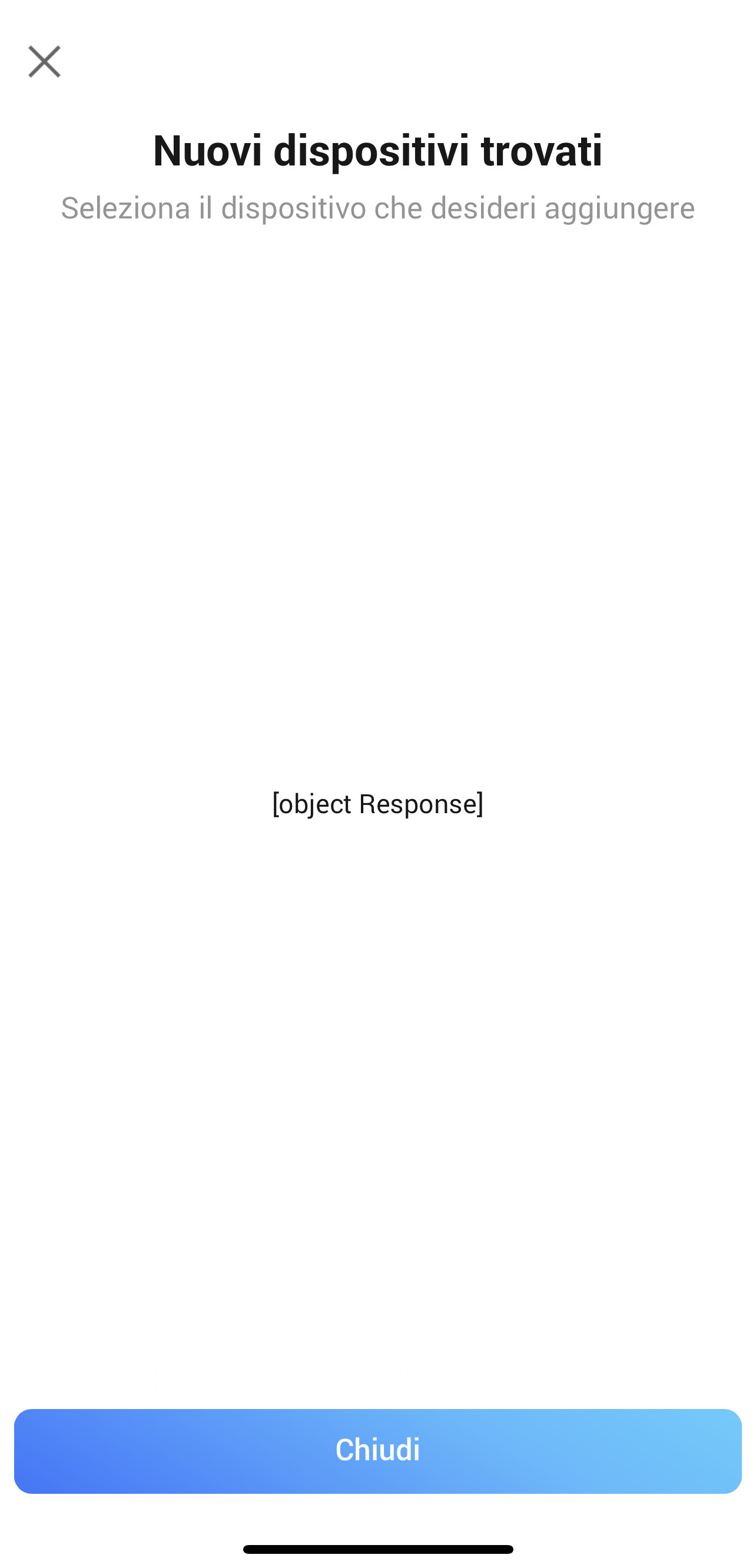

I also have problems with my H6072, H6163 and H6143. It worked until today. Asked for a new api-code, but that didn’t help. I still can control it with the govee app and with my google assistent. But not with homey. If i want to switch it on i get a red notification: “[object response]”

For testing, I am using a Homey Pro Early 2023 along with the Govee lights. Is it true that no Govee lights work with this Homey 2023? I keep seeing a [object Response] error when I try to install the light(s).
If you have any tips I would love to hear from you:) Thanks for your work and commitment to using Govee lighting with Homey.
I have no idea, i did not get one. So unable to test. I updates all the required sdk stuff and i am not getting error reports for this app. So i am guessing it should work.
