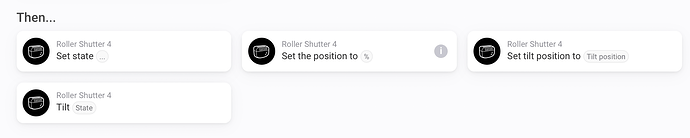

Btw, for the new Fibaro Roller Shutter 4 it seems that both functions are available.
How is that possible? A mistake? :thinking:
@DirkG @Caseda I have the roller shutter 4, but I only see “Set the position” and “Set tilt position”. No “state”.
I’m fine with using custom commands, if that’s an option, but I can’t figure out how from the RS4 manual :frowning:
If the device is included unsecure then it is possible with raw commands, if it is included secure then it’s not possible. (You can see the current security state in the devices settings) and you’ll have to reinclude it unsecure.
