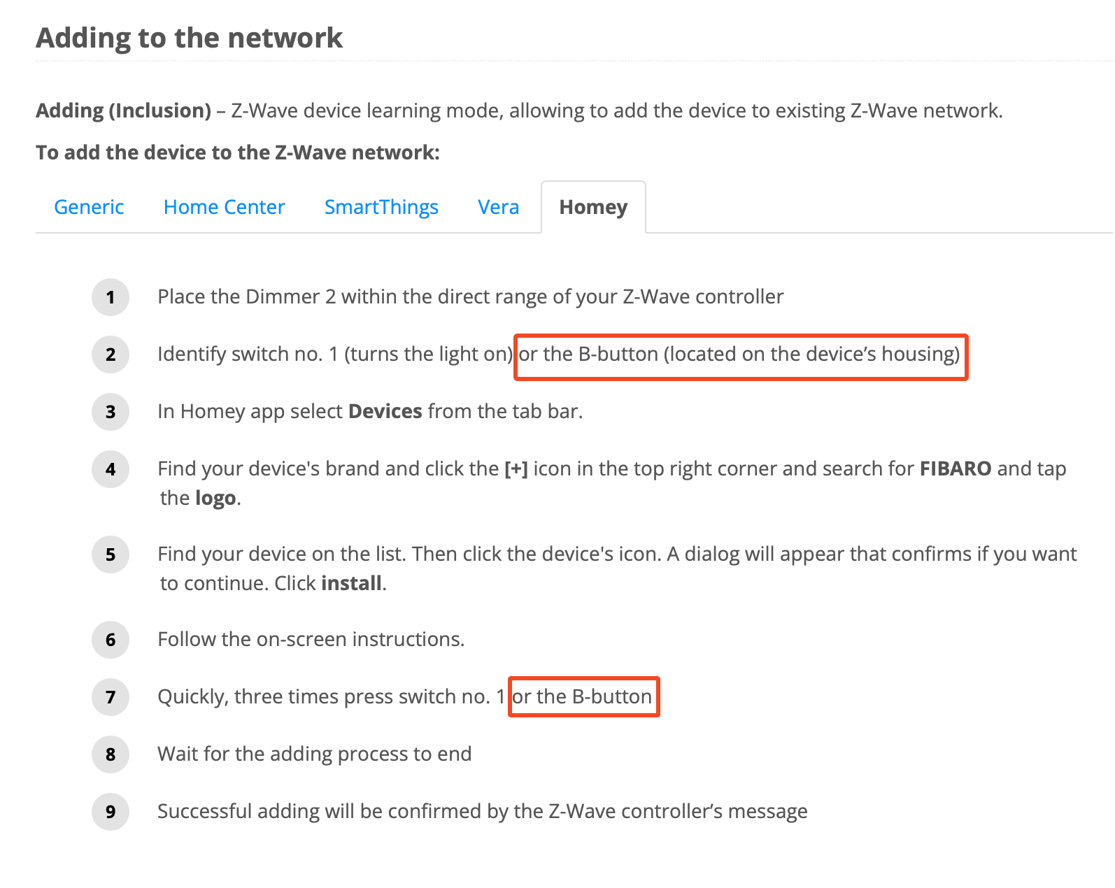

I am trying to add some fibaro s2 dimmers to my Homey Pro.
Those directly connected to switches have been relatively easy. No major dramas.
I have some others that dont have a connected switch, these i want to connect to Homey and eventually pair them with a HeatIT z push switch. The pairing part i can work out but i cant see how to add the dimmer to begin with without a switch.
I have access the switches as seen in the picture. But not sure what i can do. The electrician that wired our house set this up in Fibaro Home Center and weve been controlling things there. But now want to set it up in Homey Pro and pair it with the Heatit switches.
Cheers
It’s explained in the manual of the Fibaro Dimmer 2, which can be found in the internet.
