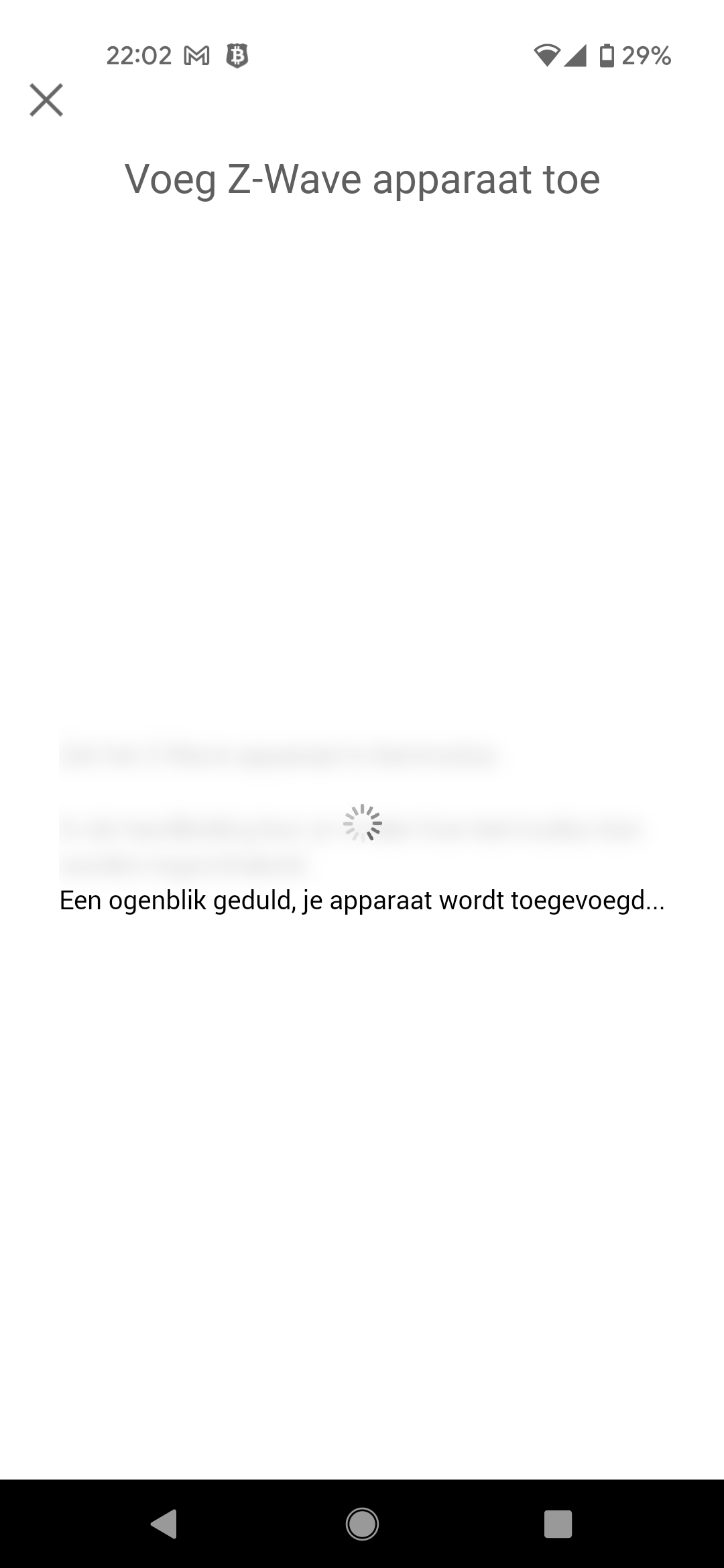

Hey Martijn or others,
Today i tried to add the ZRH12 as a secondary remote by installing it in Homey. I followed the Learn procedure as can be seen in the screenshots and got the 2 green 'vinkjes". After that, when it tries to install the remote, it ends up with an error message. It does that repeatedly. Homey and the ZRH12 are close to each other, about 1 meter.
Anyone got a clue how to do this properly?
You canât install the ZRH12 in Homey. You can only connect it as a secondary remote to the products. See my posts above.
