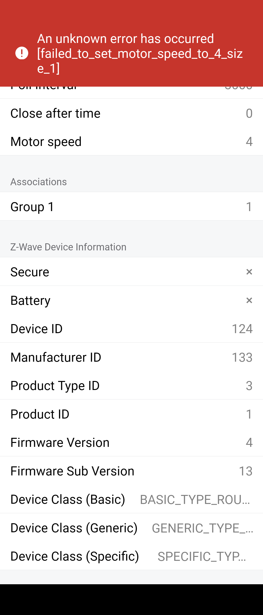

The opening and closing is slower than the normal speed. I tried changing the setting in the app for motor speed from 2 to 3 or 4 as it indicates these are available, but it produced this error:
