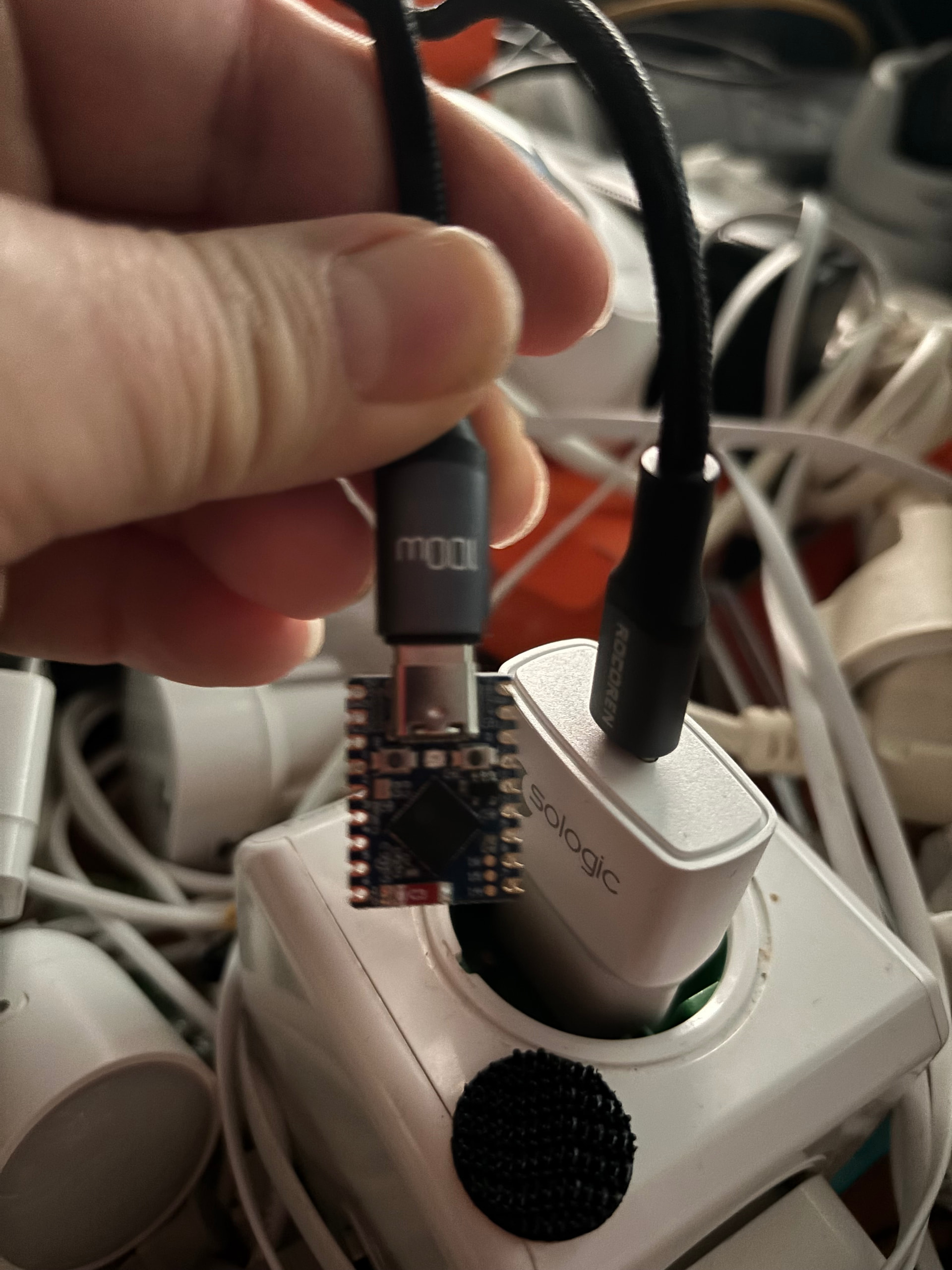

How does your ESP32-S3-Zero look like after its successful setup/flasched ?
Any led activity?
But first steps 1st. Do I need to push any of these buttons prior the flashing of the embedded s3 file ?
And what setting do I select at the start of the flashtool ? I selected ESP32-S3/Develop/USB
And set these parameters:
After it was finished I disconnected the usb-cable with the device and connected it to my powersupply. Nothing visibly changed. And no Wifi-Access point. :person_shrugging:t2:
If you could tell me what to specifically set here I could try to connect to it without being in the list of available access points:
Could it be that I ruined/broke my (2nd) device beyond repair with the attempt of installing/flashing the older/original (not) merged . Bin file ?? :person_shrugging:t2::person_shrugging:t2::white_question_mark:
There is no LED activity.
