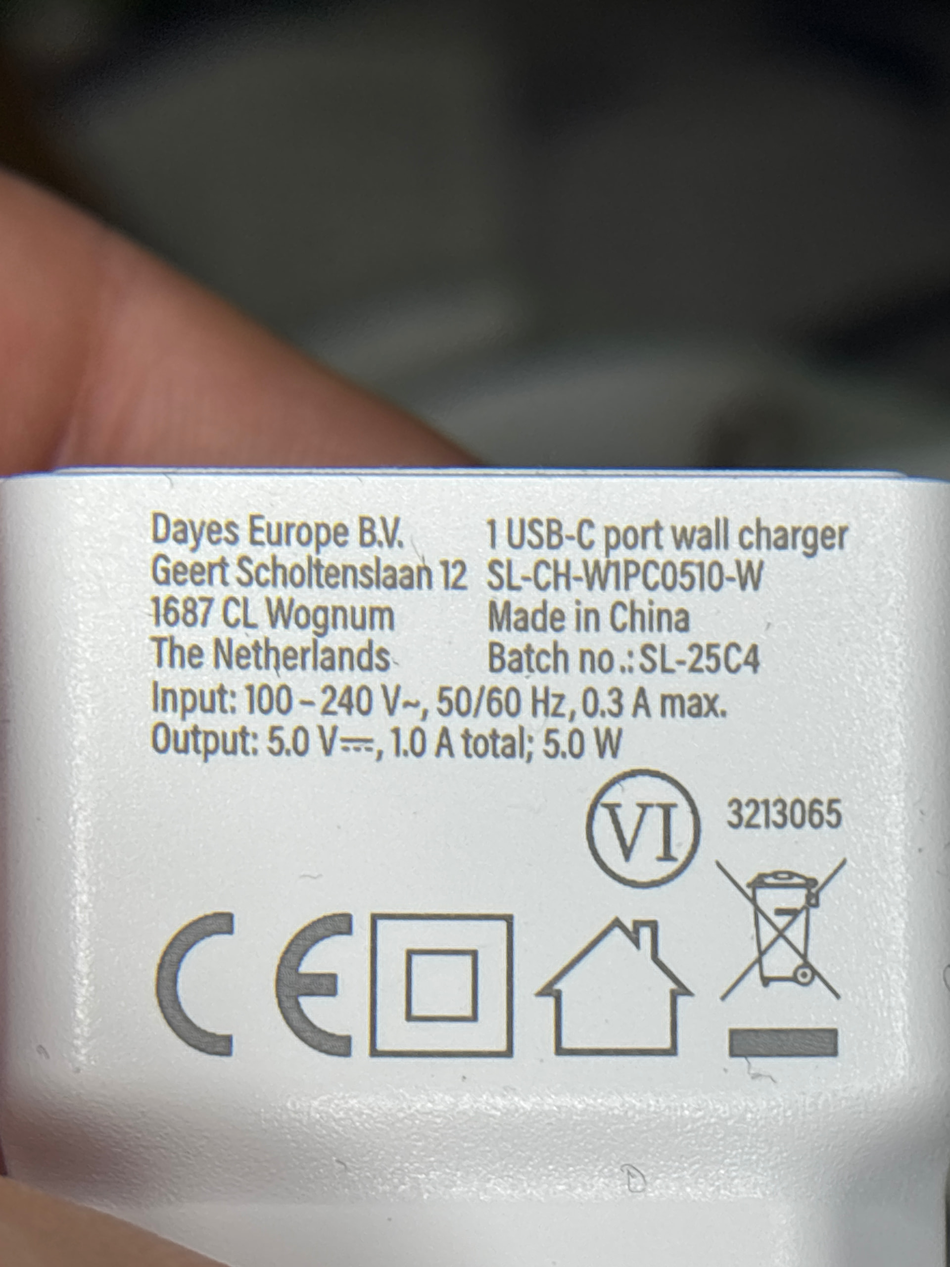

How much power does it need ?

Soecs of the powersupply I (intend to) use if its not connected to my laptop. Its just new/fresch out og irs packaging.
Same as I use them for 7 pieces of ESP32-D1 mini modules= nodes for “espresence” (still for my Home Assistant. Maybe Later I transfer to Homey.)
