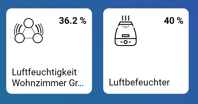

I have coupled the on/off switch with an Aqara humidity sensor. Depending on the value of the Aqara, the humidifier is switched to 25,50,75 or 100% power. It is also more accurate not to measure the humidity directly on the unit.
Screenshot_20220326-193305_Homey
