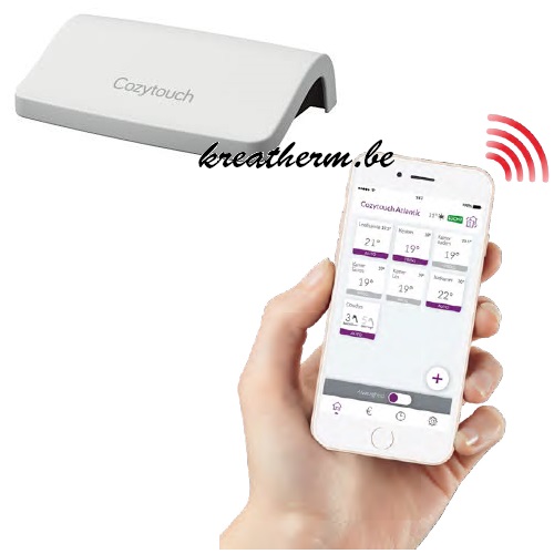

Maybe it is mentiond before but just to be shure.
I have a Atlantic explorer V4 will it connect to Homey by the Cozytouch Bridge?
and what is the difference with this one?
This is the V2?
THX!
Sorry, I have no idea. If it can be added to Tahoma then I can probably add it to the app, so maybe contact Somfy to find out.
