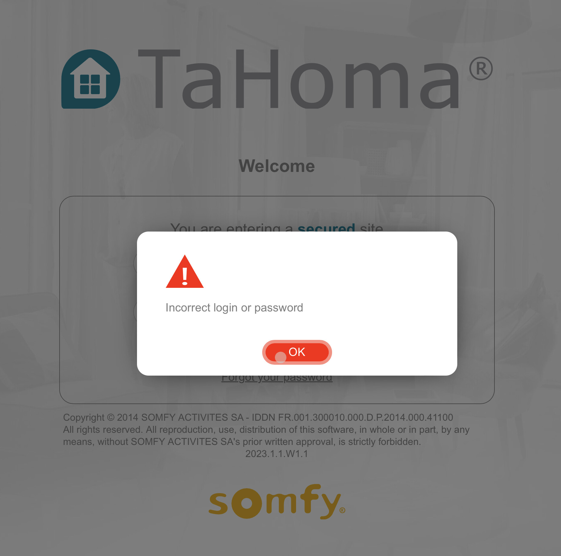

I just get this – with the same login info that works in your app
And this is after I reset my password on the Somfy site – I’ve no idea what’s going on :stuck_out_tongue:
Maybe I should reset my password from this page?
I think it would be best if you contact Somfy. As it’s an issue logging into their site they should be able to check your account.
I have always found them to be very helpful in the past.
Will do - thanks

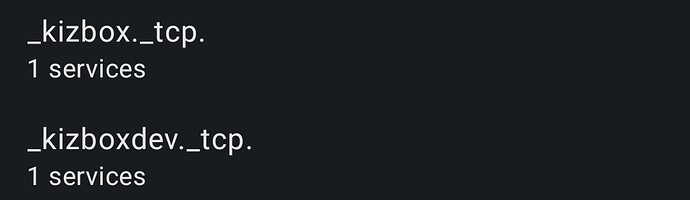

Info service browser…
so mdns broadcast doesn’t seem to be the problem

then that will be more the problem other mdns such as philips hue mdns and Chromecast are good and findable
