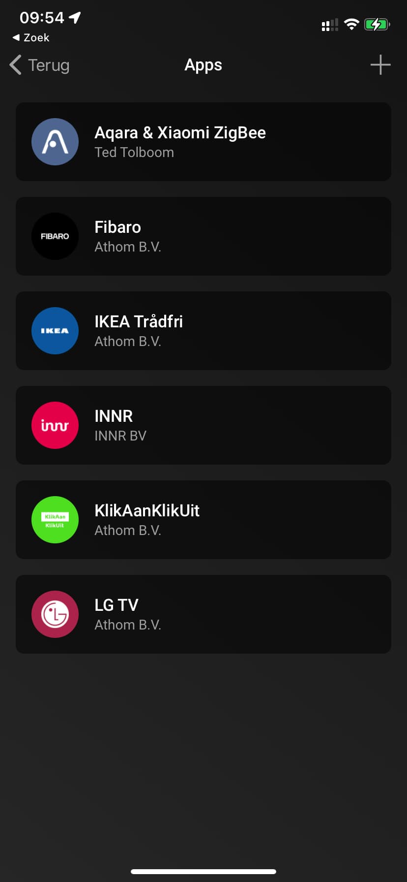

I just had another look, and the app is still present on the “add device” page., while is is missing on the “apps” page. Maybe this inconsistent state causes the problems?
If this is the case then it should be solved by Athom, as I have no way to completely and consistently remove the app.
