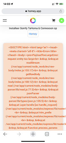

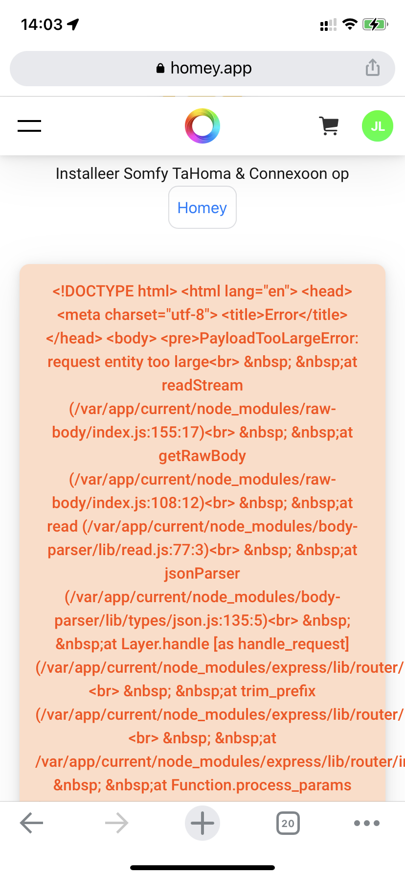

This is the sequence. App has gone from my homey (cloud)
Hmm, that looks like a store issue. I have requested support from Athom and pointed them to this topic so hopefully they will let me know what the problem is.
Just out of interest, are you installing it from a phone?
If so, could you install it from a web browser on a desktop?
I’ve tried phone, ipad and windows laptop with chrome. Same thing.
I have published again as version 3.0.12 just in case that helps. The code is the same but I have updated a couple of store images to meet the store requirements.
