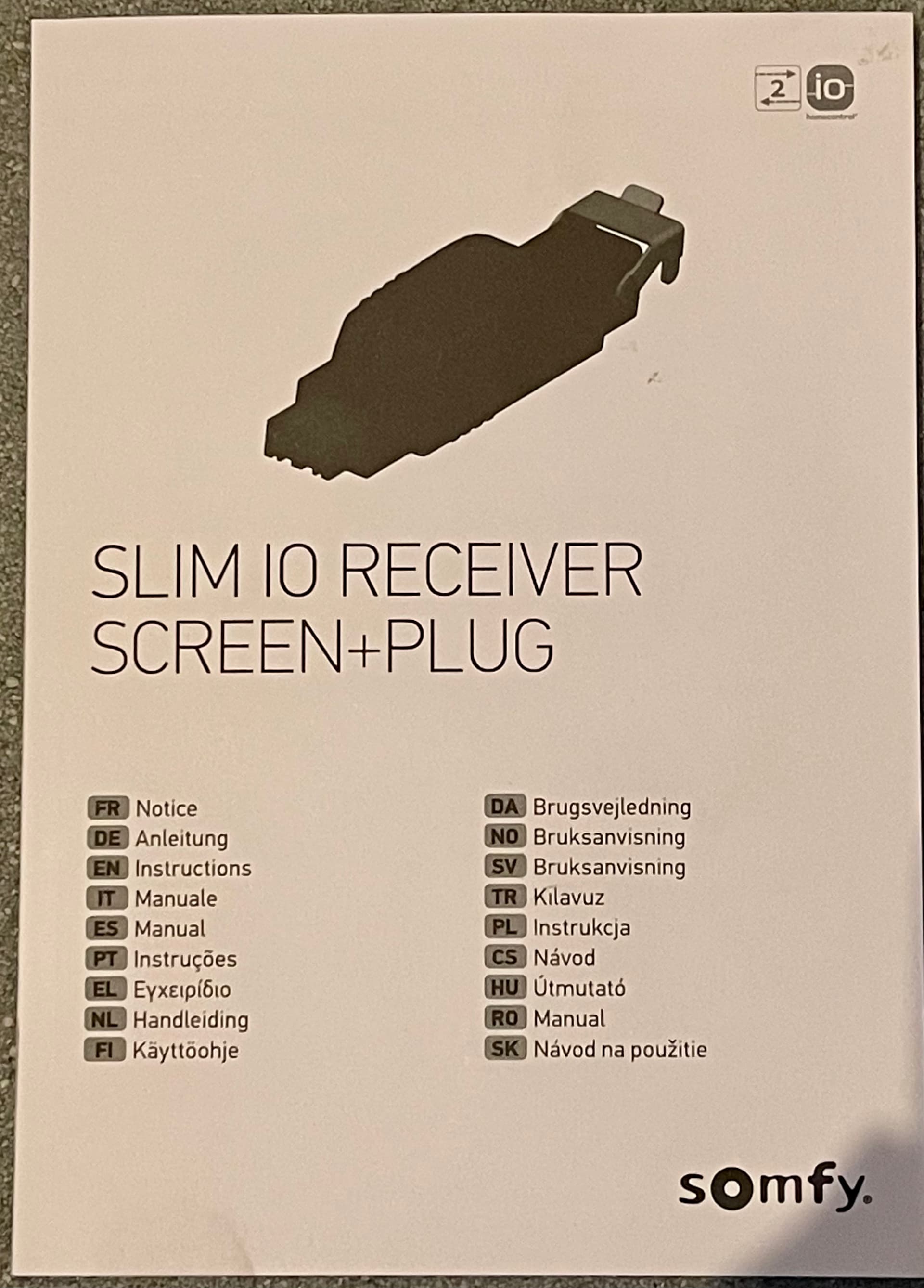

Hi Adrian, so many thanks for your excellent work!
My lights are working fine, but I cannot connect my heaters and sunscreen.
Is it possible to add these?
I’ll add the front page of both instruction manuals.
Could you send me the device log as described in the first post?
Hi Adrian, I just did a few seconds ago.
I hope you’ll have enough information?
It will really help me, thanks in advance!
It looks like the current test version supports all your devices.
Wow, that’s great, thank you so much Adrian!
