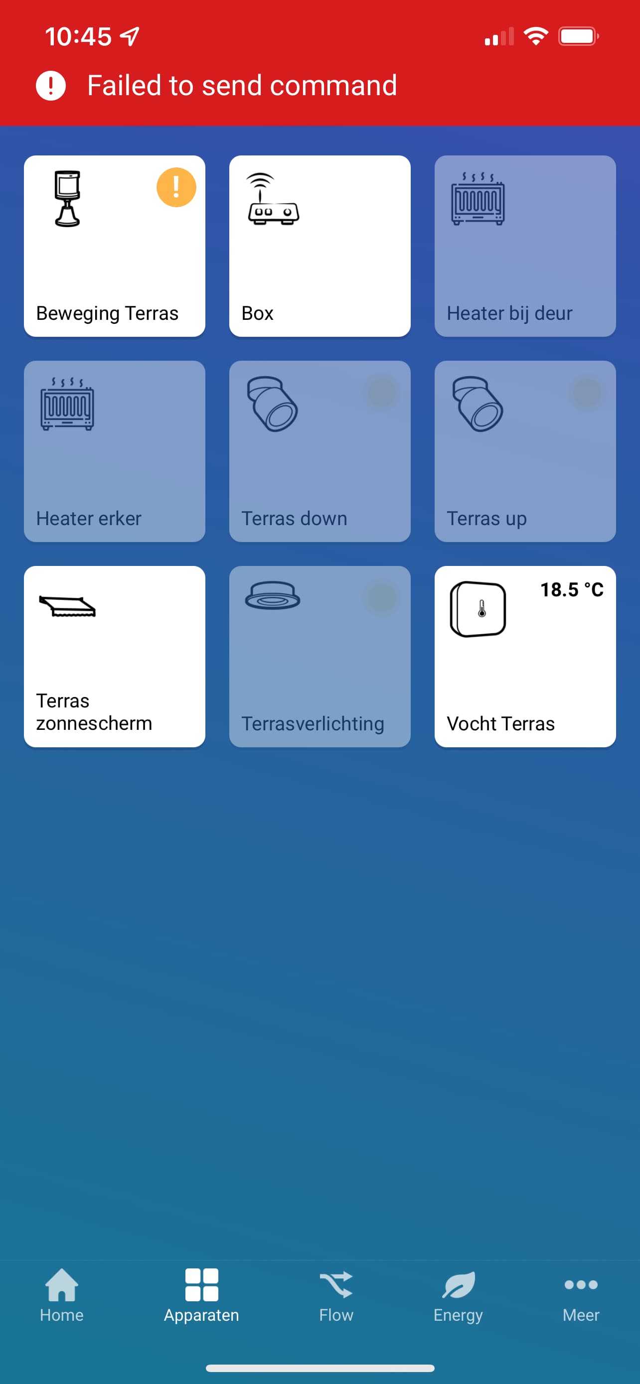

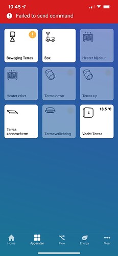

The sunscreen works perfect (not yet tested in a flow), but the heaters gave an error message.
Hmm, yes, something does not look right with the command in the log. I don’t think the ‘on’ command needs any parameters so I will investigate this evening.

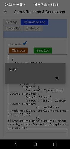

When I try to send the log I also get an error.
Hmm, interesting that the messages in the log appear to be timeouts and you get an error when trying to send the log. My first guess based on that is that Homey is having internet issues. As you are connecting to Homey via the phone your LAN must be working but possibly not the external internet or at least the DNS is not working.

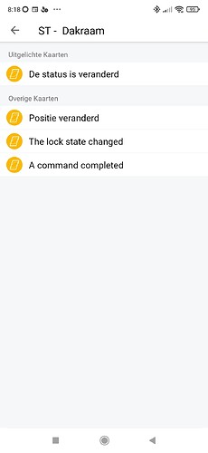

In the device screen, I have this;
What does that mean? Normally I see flow history here.
And as flow cards I see the english options:
What do these do?
The Lock State is information from Tahoma that is set to a condition that would prevent the cover from moving. For example, a canopy might have a wind sensor connected that prevents the canopy from opening if the wind is to strong, or a window might have a rain sensor that prevents it from opening if it’s raining. I don’t know the full range of messages as that depends on the device and the app will just show the message that is received.
“The lock state changed” flow trigger will be activated if the lock status message changes. I think it includes a tag that contains the message, but I don’t have the code or a device with that feature to check that.
The “A command completed” trigger is fired when the Homey app receives the command finished status from Tahoma. So, when you move the cover, Homey sends the command to Tahoma and then continues about it’s business. Meanwhile the cover moves, which could take tens of seconds to complete. Once it has reached it’s destination it informs Tahoma (provided it is an IO device). Then Tahoma sends the command complete status update which Homey receives when it next polls for events and it fires the trigger card.
