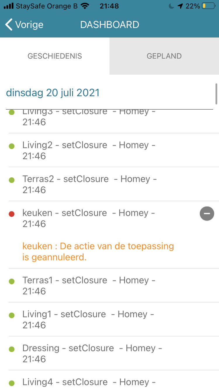

The last few days i noticed that when i set a position to rollershutters i grouped together with the group app into one device, theres always one or two who dont react. When i test the flow afterwards, they do what i asked… i increased the delay in advaced settings to 100, but no difference. Im also not sure its homey that gives the error, becausse the command arrived at my connexoon
Unfortunately the timeline only supports boolean capabilities.
I’m glad you mentioned that the command arrives at Connexoon as that lets me off the hook :wink:
If you enable the information log and send it to me straight after a failure and I will see if any failure code is returned. Unfortunately the size of the log is limited and works on a first in first out principal so it might not contain all the data with so many shutters operating at the same time.
It just happened again, every time different rollershutters who ignore the command btw. In the informationlog i see times from 2 houts ago, but nothing with a time thats arround now. Sent the log anyway, i hope theres a timedifferenceerroršŸ˜‹
I can see a few failures in there but will need some time on a big screen to analyse it properly.
The time reported is UTC so I presume you are 2 hours ahead.
Thanks a lot, that explains it, because the minutes looked right to me
Athom changed the way Homey handles time in one of the updates. Previously, Homey’s clock was set to local time but now it is set to UTC, so the JS time functions now return UTC instead of local time. They say it is for better consistency but it broke a lot of apps that depend on time.
Anyway, back to the log. It looks like something is sending commands twice. For example, Dressing was told to close at ā€œ21/07/2021, 20:10:20ā€ and again at ā€œ21/07/2021, 20:10:32ā€. As the first command has not completed, it is canceled so the new command can be issued. In theory, this should be OK but I wonder if the gateway is struggling with such a huge amount of commands to process all at once.
One thing I will do is check if the new command is the same as the command being executed and just ignore it if it is.

I send the commands 2 times now, with 10 seconds difference to be sure they get to their position. Before it happend also, but more frequently. Ill set the time more apart and let you know how it goes
Have you seen that in the latest version there is a new When card for ā€œA command completedā€?
This has a local tag for success so you could try adding a flow to check for and log failures.
