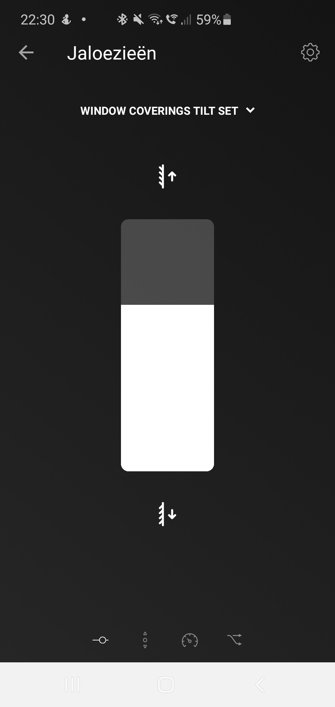

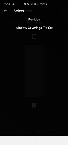

To control the slat tilt you need to select it from the drop list on the control screen. The default is to show POISTION:
but by tapping on that it drops the list down and you can select Window Coverings Tilt Set.
The slider then shows and controls the tilt.
This is the way Homey handles multiple controls of the same type such as sliders, power buttons, pick lists, etc.
