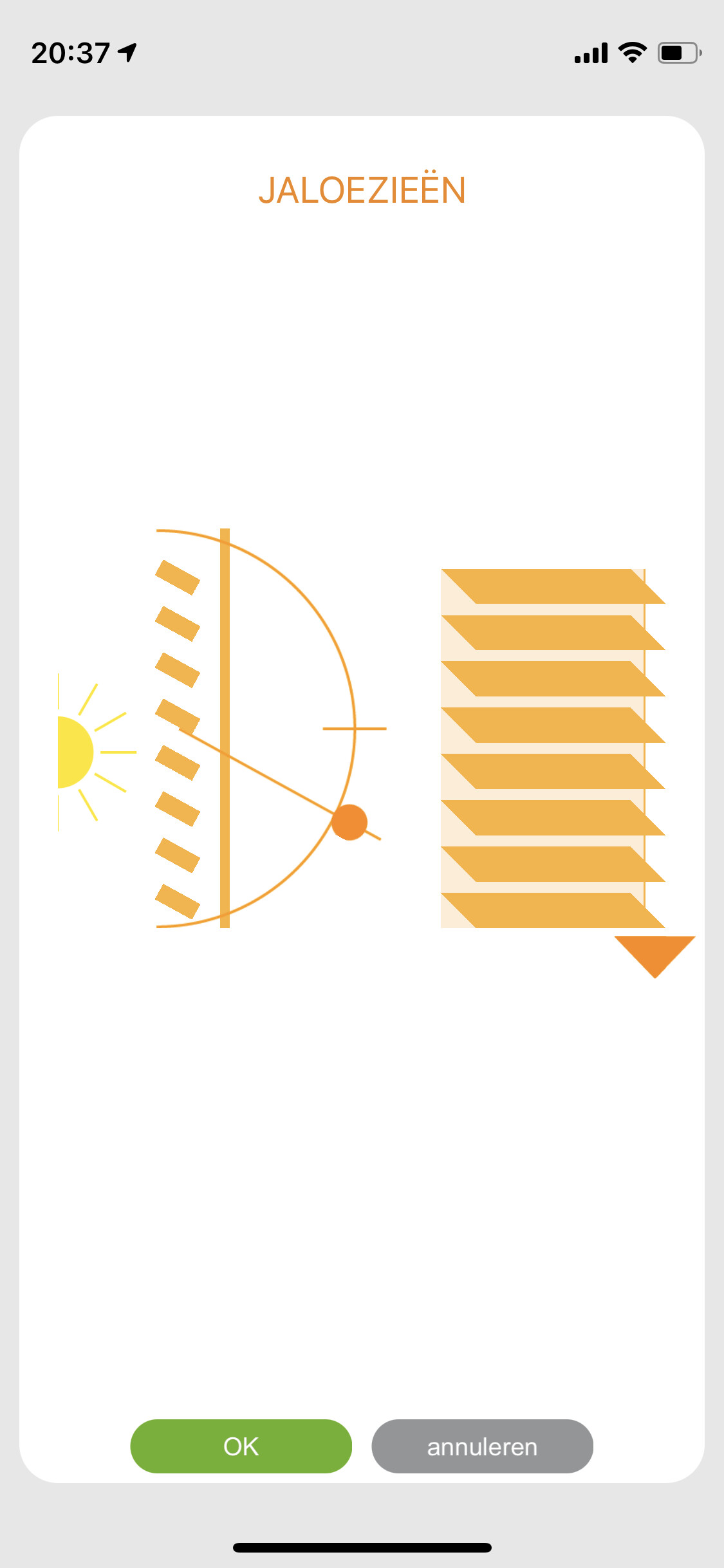

Recently my horizontal blinds got installed and added to my Connexoon. In the Connexoon I can tilt and lift them, and see the current status as well. In Homey I can only see the lift status (0-100%), but I can’t see the tilt. Is there a way to do this?
Currently I can set them to some presets using the scenes I created in the Connexoon. But since we tilt them with the remote too, I can’t use a variable in Homey to determine the current tilt status.
Thanks in advance!
Can you send me the device log so I can check the capabilities that are returned by the API?
Thanks for your quick reply! I’ve sent the device log. The mentioned device is called “Jaloezieën”.
