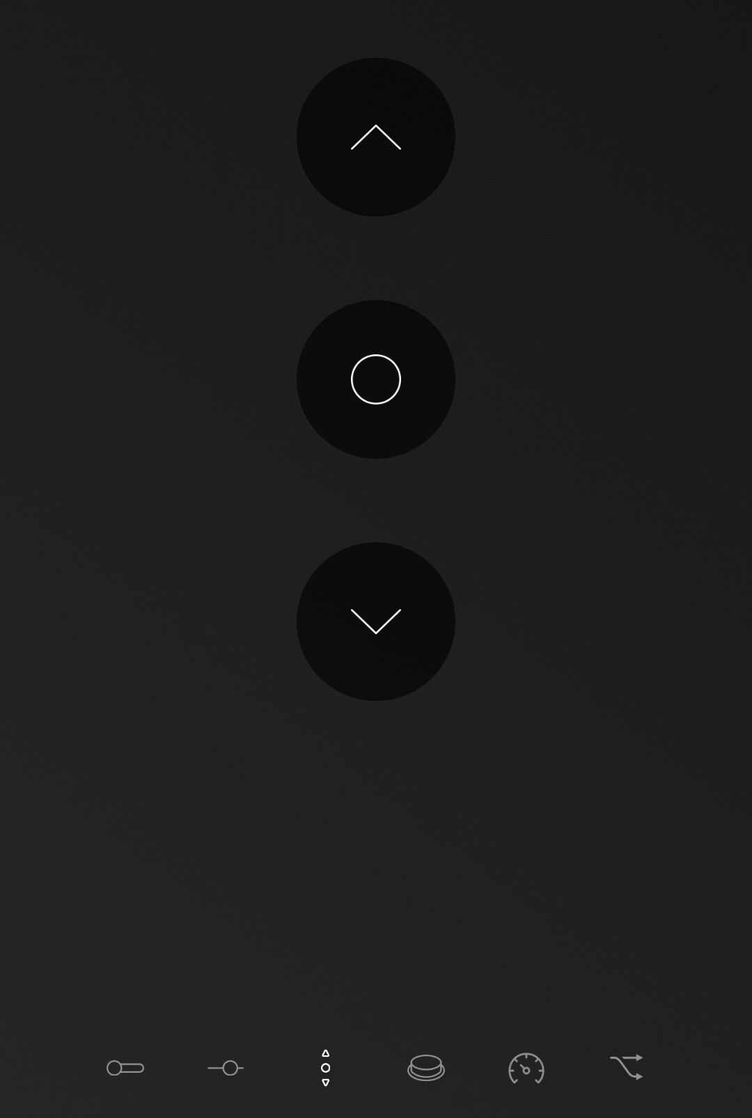

I think I have tracked it down. I am guessing that when you mentioned the MY position you were referring to the idle / stop button on the screen that has the Up / Idle / Down buttons?
I found that the stop button was not being implemented and therefore sending a null command. I have now mapped that in to the Somfy Stop command.
What you should also find, on the next screen is the MY POSITION button. This will send the shutter to the pre-programmed MY position. There is also a flow action card to do the same.
I think I remember the stop button having a dual action of Stop or MY position when I took over the app. But that was causing problems, as the app can not detect for sure if the cover is actually moving due to delays in the communications. So, it was unpredictable if the button would stop the cover or move it to the MY position. Therefore, I split the two functions to separate buttons for safety.
To summarize, you will need to change any flows that want to move to the MY position so they use the new ‘Move to MY Position’ action card. Also if you want to manually move to the MY position using the app, then you will need to tap on the new ‘MY POSITION’ button.
Sorry for the confusion I caused with that change.
It was probably dual action since that is how the remotes work. However, they are 1-way (almost certain), so the shutter must be interpreting itself if it should stop, or go to MY.
At least I don’t get the error message anymore. Thank for the last update.
If the Stop button is meant for stop only and not for MY position isn’t it nice the make a motion next to it “Stop only”?
What you say, but now it only works as a stop button. (Since last update)
If that is the case then the middle button in the app should do the same. However, from the API, ‘stop’ and ‘my’ are separate commands, so it possibly works differently than the remote.
All my blinds and curtains are RTS and they have a seperate MY button. Maybe because they have no read back capability.
Unfortunately I have no control over the display format for that screen as it is the way Homey displays that capability.
@Geurti Come on, how hard can it be. There is also no “up only” and “down only” and the circle icon does not mention MY in any way. People have a separate my position page with a button. From my point of view no need to mention on the page it’s “stop only”. The good thing is you could automate the things you want. Close / open / ventilation (my position) with a flow.
