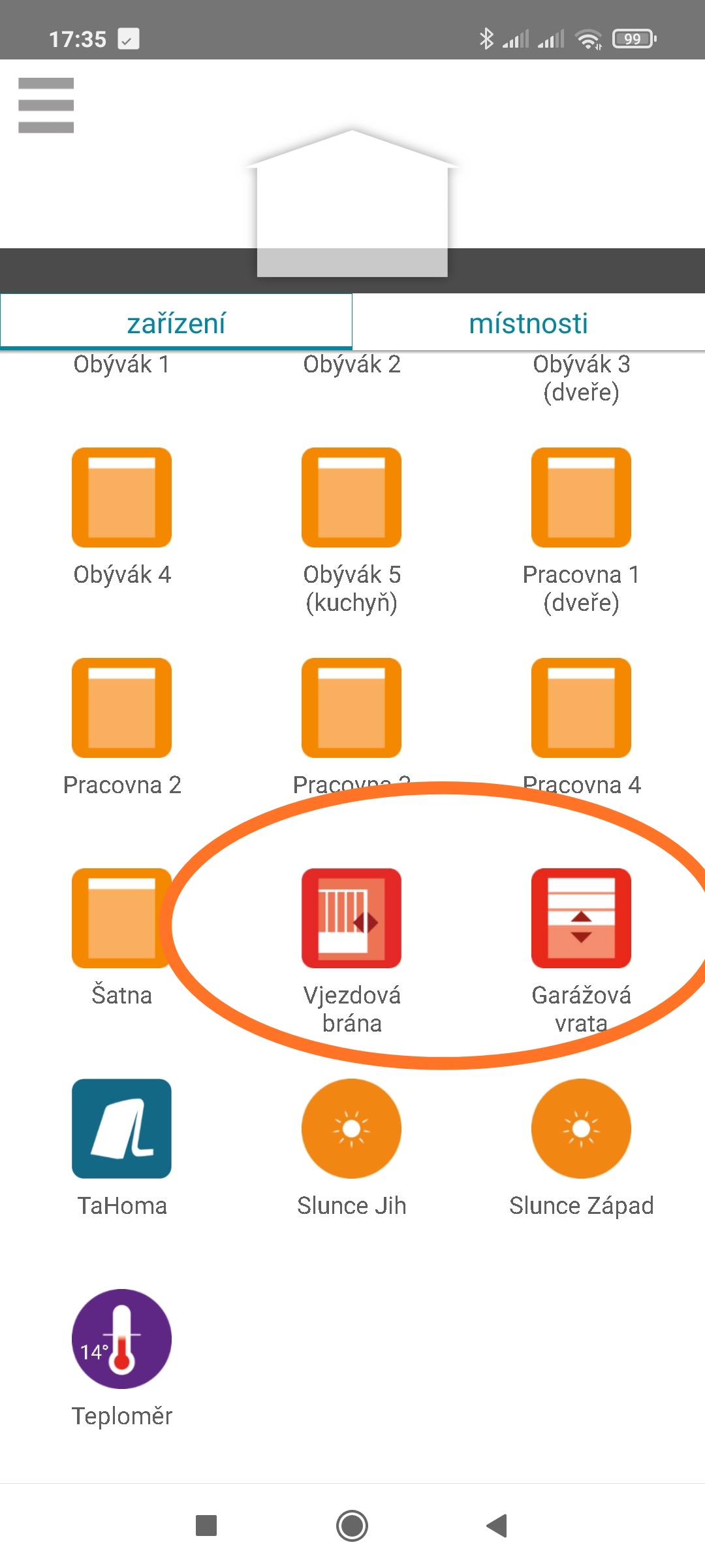

Hi Adrian, i see you are adding RTS devices too. What do you need to be able to add RTS universal actor? https://www.somfy.me/en-gc/products/1810624/universal-receiver-rts thank you
Does it show up in Tahoma?
If so then send me the Device log and I will see what I can do.

Yes, it is in Tahoma as rts device.
I have hard time to receive the Device log. After pressing the button I dont receive any log and the window stay empty.
