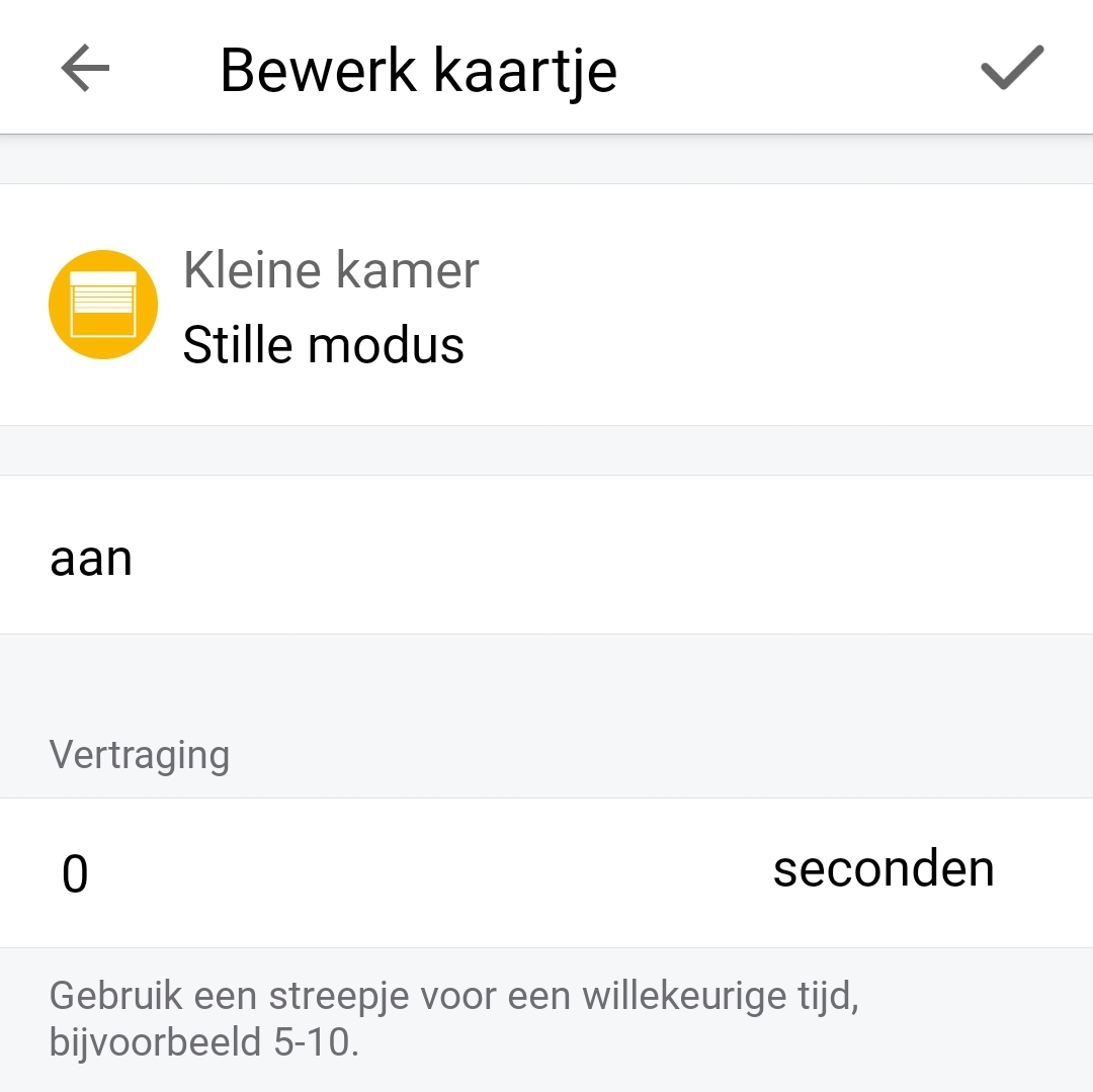

@rvdeijk Can you use quit mode (feather) for your roller shutters when using the Homey App?
On of my Somfy IO roller shutters has this option on the hardware remote and also in the connexoon app. But not in Homey :sweat_smile:
Yes I can. Maybe you have to re-add the roller shutters and choose the right one:
Screenshot_20201021-100350_Homey
Then you will have a quiet mode flow card and there is a toggle available at the device page section:
If it doesn’t work, then contact Adrian to help you out. Probably then you have to gather a log, maybe some parameters are different.
Thanks for the info. I simply assumed it wasn’t supported…
…but I’ll try re-adding them :+1:
Update: that worked, I can now also use the quite-mode. Time to update my flows, I guess :slight_smile:

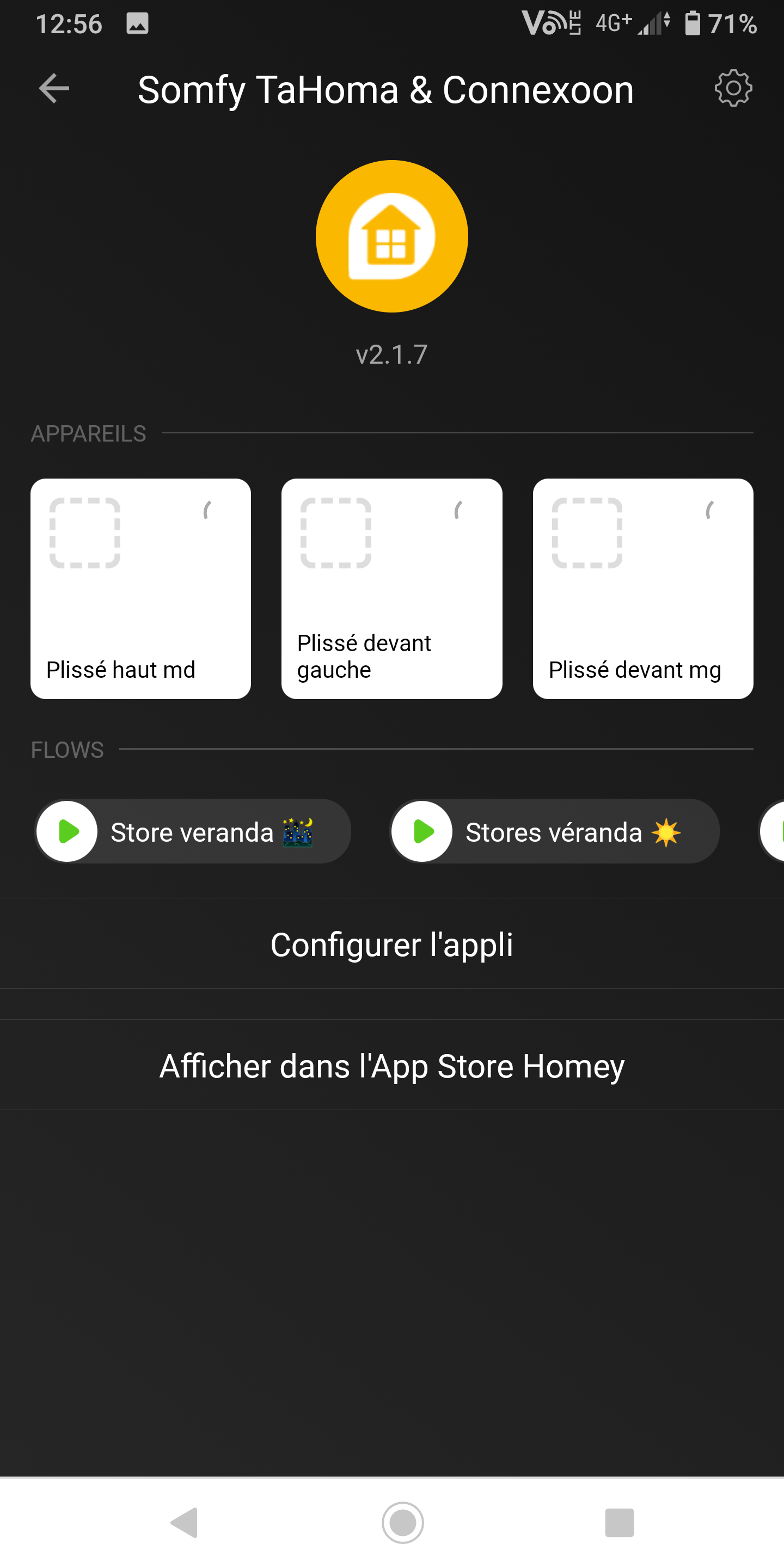

I have the problem with the APP that it is on Pause! Restarting Homey, nor the APP is useless. I have the error message: Timeout 3000ms.
This problem I already had, I uninstalled and reinstalled the APP. Its to solve the problem on the other hand I had to put all the blinds and skylights and adapt the flows. Its done too much work if there are any solutions!
I cannot access the APP settings!

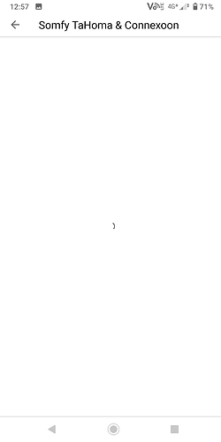

I cannot access the parameters, the page remains blank with the wheel turning. I also have the impression that the APP does not react to restart or other, it is deactivated and still on the page of the 'APP she is looking for the blinds !?
When I activate the APP its going long enough to start up, with the error message in the red bar at the top: Timeout after 3000ms
