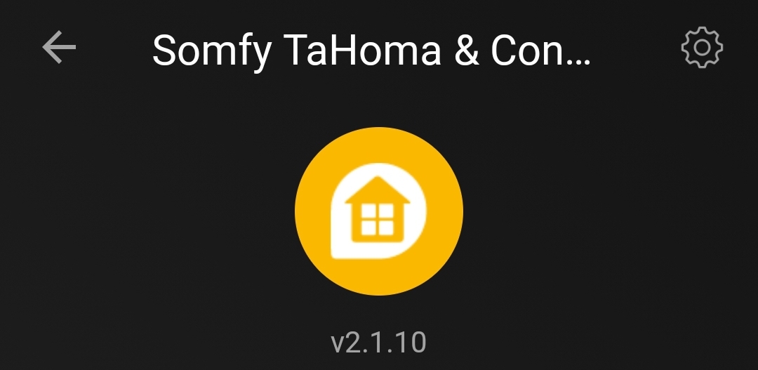

I tried to install 2.1.10, but somehow it doesn’t install. Maybe homey appstore have some issues? The app still shows 2.1.8.
Very strange. Maybe try again later. I know a couple of users have installed it yesterday.
Apparently Homey was the whole night in some installation state, seems it got stuck:
20201028_075037
I did a PtP and now 2.1.10 installed fine:
No idea what went wrong, but it works now :slight_smile:

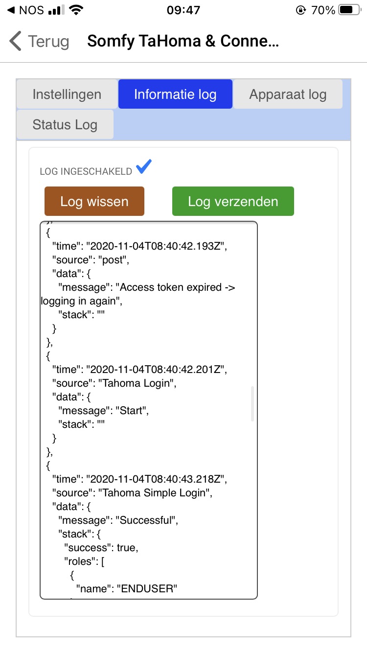

@Adrian_Rockall I’m using the latest stable version, and I have to restart the app every hour. I checked the log file:
I haven’t experienced this before in any of the previous versions. After a restart, the app works as is should. But for a limited amount of time.

The token does expire after an hour (Somfy does that) but the app should automatically renew it. In the image of the log it does appear to be doing that OK.
v2.1.12 is now live and I have made changes to try and improve the login so maybe that will fix the issue.
