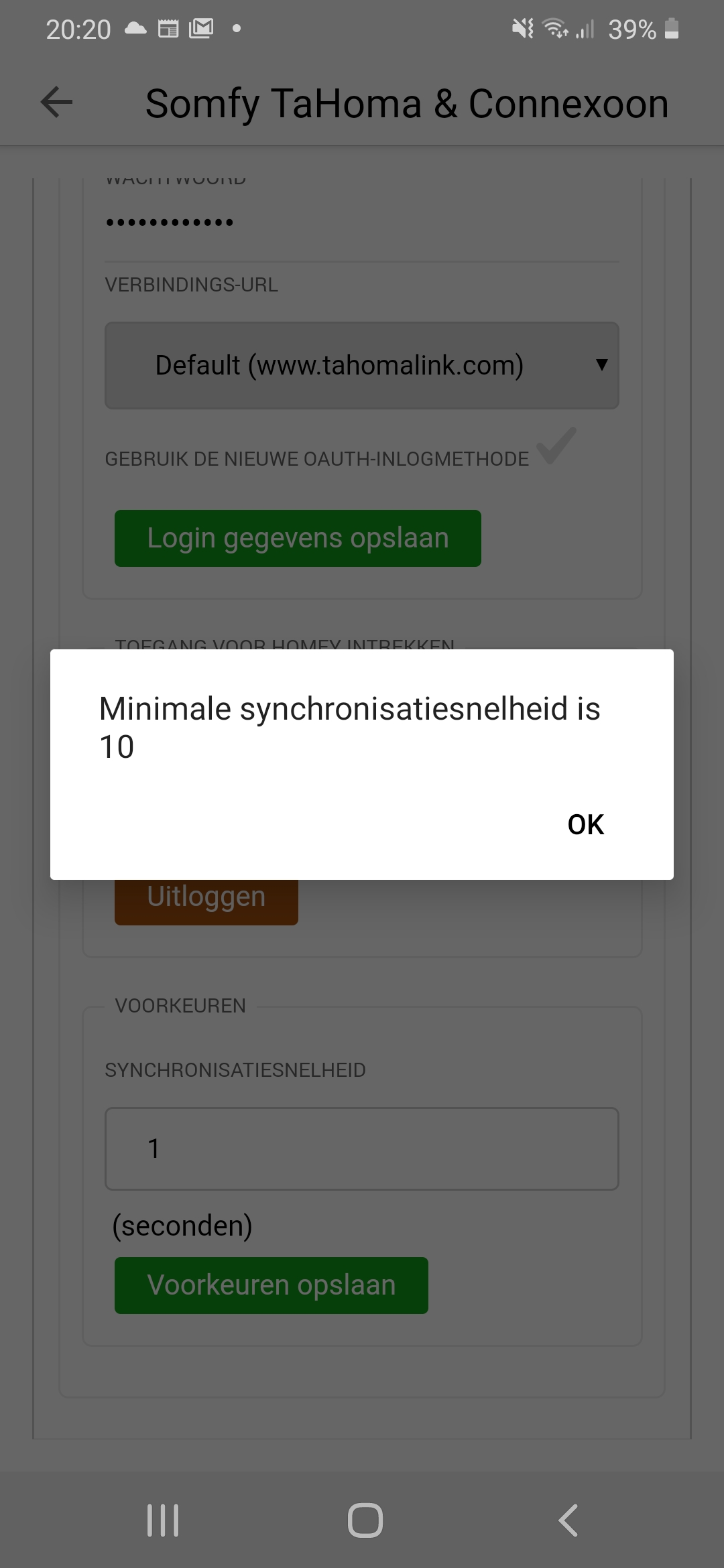

It looks like there is a bug in the Homey app. Even the alert message is not showing in the app, but it does work in the dev portal. Also, the setting is being saved so the button click is working.
It looks like a problem when the screen must scroll down to see the button.
I will report it to Athom to see what they say.
I do see an alert message when I fill something in that is less than 10 seconds:
I just don’t get a confirmation that the preferences are saved when I fill something in that is higher than 10 seconds.
That’s even more strange as the code for both is the same. I will take another look to be sure.

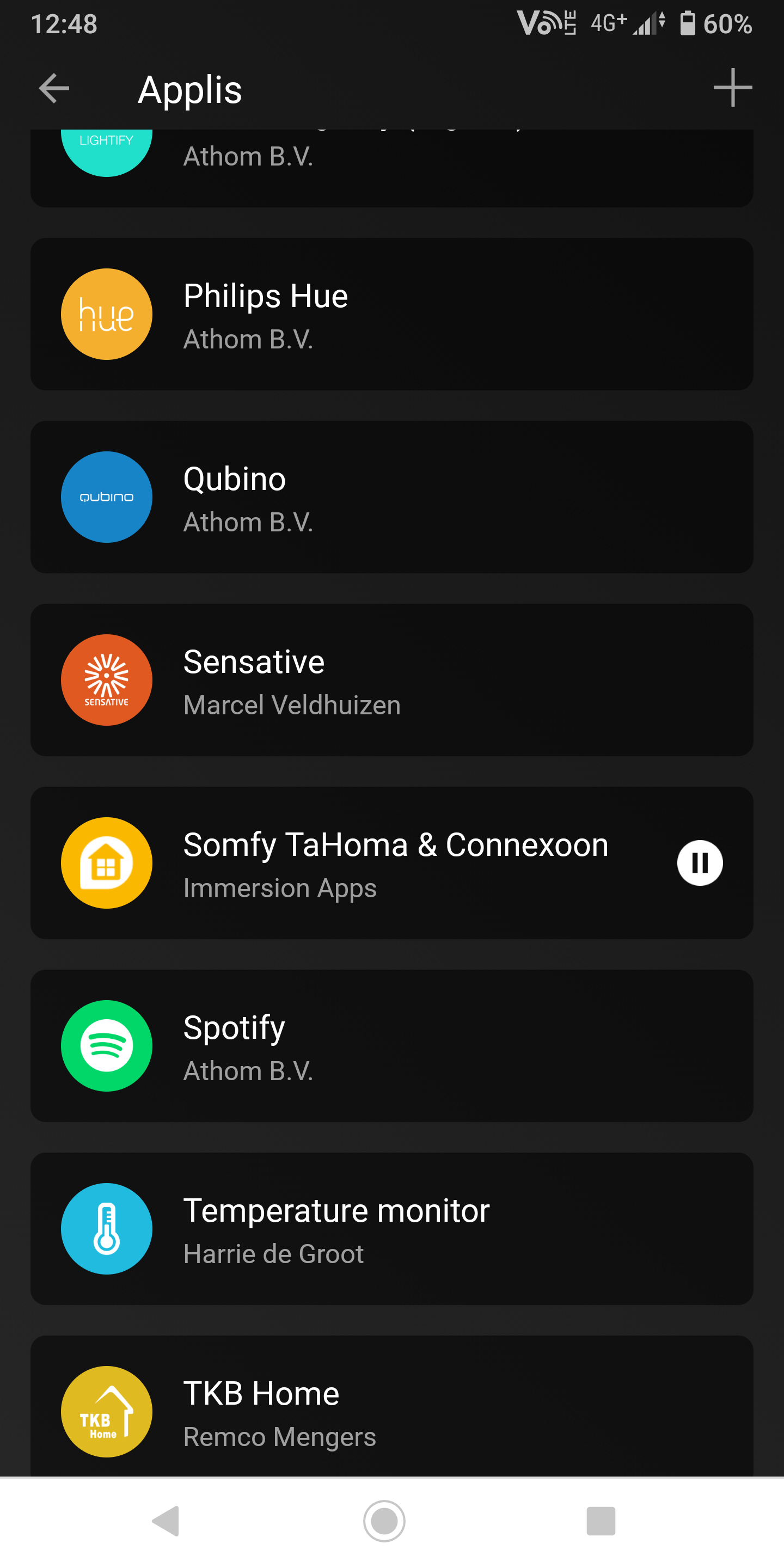

On page with apps on Homey, the Somfy app has a signe with “II” (paused)!
excuse me for me english
Could it be that you saw this after you restarted homey? Cause then the apps are still loading / starting. The II sign should disappear within a minute. Or there is an error and @Adrian_Rockall can maybe help, then it looks like the app crashed?
I also see you aren’t logged in. Fill in your credentials (username/password), use default server and OAuth off and log in. If it does not work then try with OAuth on.
The pictures are after we restart homey and app.
I have deactivated the app for few minutes, when i restart the app i have the same problems.
