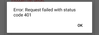

I’m not sure. The 401 means not authenticated. These will occur naturally as the server will end the session every so often. OAuth session last a maximum of 1 hour. The old method last much longer but I don’t know how long.
When you change the Sync Speed it just stops the polling timer and starts it again with the new value. So no logging in or out, etc.so I can’t think why that would cause the problem.
Maybe the old session length is based on the time of the last communication. So polling every 10 seconds keeps the session alive but a quiet period of 600 seconds allows the session to terminate.
It should recover from those automatically so even though one appears in the log it should just trigger a new login.
I use the old method and indeed I think with 10 seconds it keeps the session alive and with 600 seconds not. I do get the error already after a few minutes when sync is set to 600.
But is there a solution? Cause right now, the moment I press for example a tile of a device (roller shutter) I receive this 401 error. When I press the same tile a 2nd time (within 1 sec) then the device does react.
So somehow the app should authenticate (open the session) first and then it should send a request to the servers. Right now it’s apparently the opposite and because of that I receive this message?
What it should do is assume the session is authenticated once logged in but if it gets one 401 it should login again and then retry the command.
If a session is already authenticated then the app has to log out first before it can authenticate again. Logging in and out puts quite a load on the server so I try to keep that to a minimum.
Obviously if it fails to send the command then something is not as it should be. I will set my sync speed to 600 and see what happens. Obviously my door sensors and Sunis are not very useful at that speed though :slight_smile:
That sounds like a solid solution indeed. :smiley: And the first time it’s not needed to show an error (it scares people), cause probably after logging in and a retry of the command the device will work.
Correct, but in my case, nothing is wrong. Cause within 1 second the device does work.
So of course when the 401 remain then indeed the error is valid and not because of some timeout of the previous session. If I could help to debug something, then please let me know and I will try that.

I tried it with 2.1.0, cause then I could clearly see the 401 error that have been fixed in 2.1.2.
Sync speed at 250 gave no errors, sync speed at 275 did. Then I tried 265 and I got no errors, but when I wanted to try it again it was automatically updated to 2.1.2. So my backup plan would be to check the log and so far no issue. I think I will set it to 240, then I have a poll ratio of 15x hour (360x per day). Enough for just roller shutters :slight_smile:
The weird part is that during my tests I suddenly had to switch to OAuth on, while I was always on the old method. So maybe Somfy is upgrading accounts to force OAuth? If I didn’t use OAuth I received:
On the new version you should see the status message “Token expired - Login Again”, or something like that, instead of the Error:
