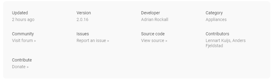

Also, as so many people have asked, I have added a PayPal link to the store. Although I still don’t expect any donations but it’s there if it makes you feel better :wink:
Am I correct in assuming that this link will only become visible as soon as the new version is released as stable?
I for one don’t see the option (yet).
Since I’ve been only lurking thusfar… I also want to take the oppurtunity to express my thanks for all the work you’re putting into this!
You may not expect donations, but you will have them, I’m sure.
It should be on the test version page. It appears in the lower information panel as Contribute - Donate.
Yes, but the question is, will it also appear on the normal version page?
