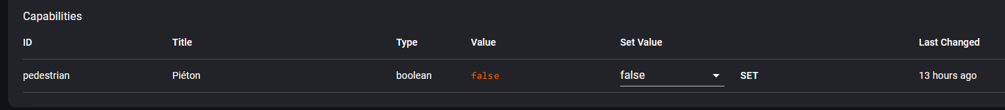

@Adrian_Rockall - Quick question : it seems like the sliding tab has disappeared from the UI since last week (or so). I just have the pedestrian tab now. Did you change anything for the sliding gate recently ?
The last change I made was to add the position slider for the ‘io:slidinggateopeneriocomponent’. So nothing should have been removed.
By the sliding tab do you mean the buttons to open / stop / close?
yes, there used to be 3 tabs:
  • the sliding tab (open/stop/close)
  • the pedestrian tab (only 1 button)
  • the automation tab (flows)
Recently, only the pedestrian one is showing since the update.
So, has the Flow tab vanished as well?
If you go to https://tools.developer.homey.app/tools/devices and find the device in the list, does it have the windowcoverings_state?

No, the capability is not here anymore, only pedestrian.
I understand now why it is not in the UI, but i dont see why the Sliding gate does not have the windowcoverings_state anymore.
And the flow is tab is still here.
Something coming from the Tahoma bridge ?
I don’t think it’s a Tahoma bridge issue.
All i can suggest is to delete the device from Homey and add it again to see if that fixes it. Unfortunately it will mean you have to fix any Flows that use it.
