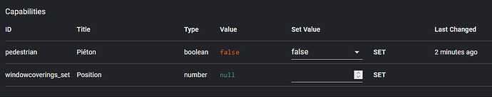

I removed the device and added it again : the sliding tab is back. I can see as well that the design changed (not the same icons) and it is more clearer than before.
I dont know why the tab disappeared but i guess an update somewhat with the new setup/design of the tab could have been at the reason.
Removing and re-adding the sliding gate fixed it.

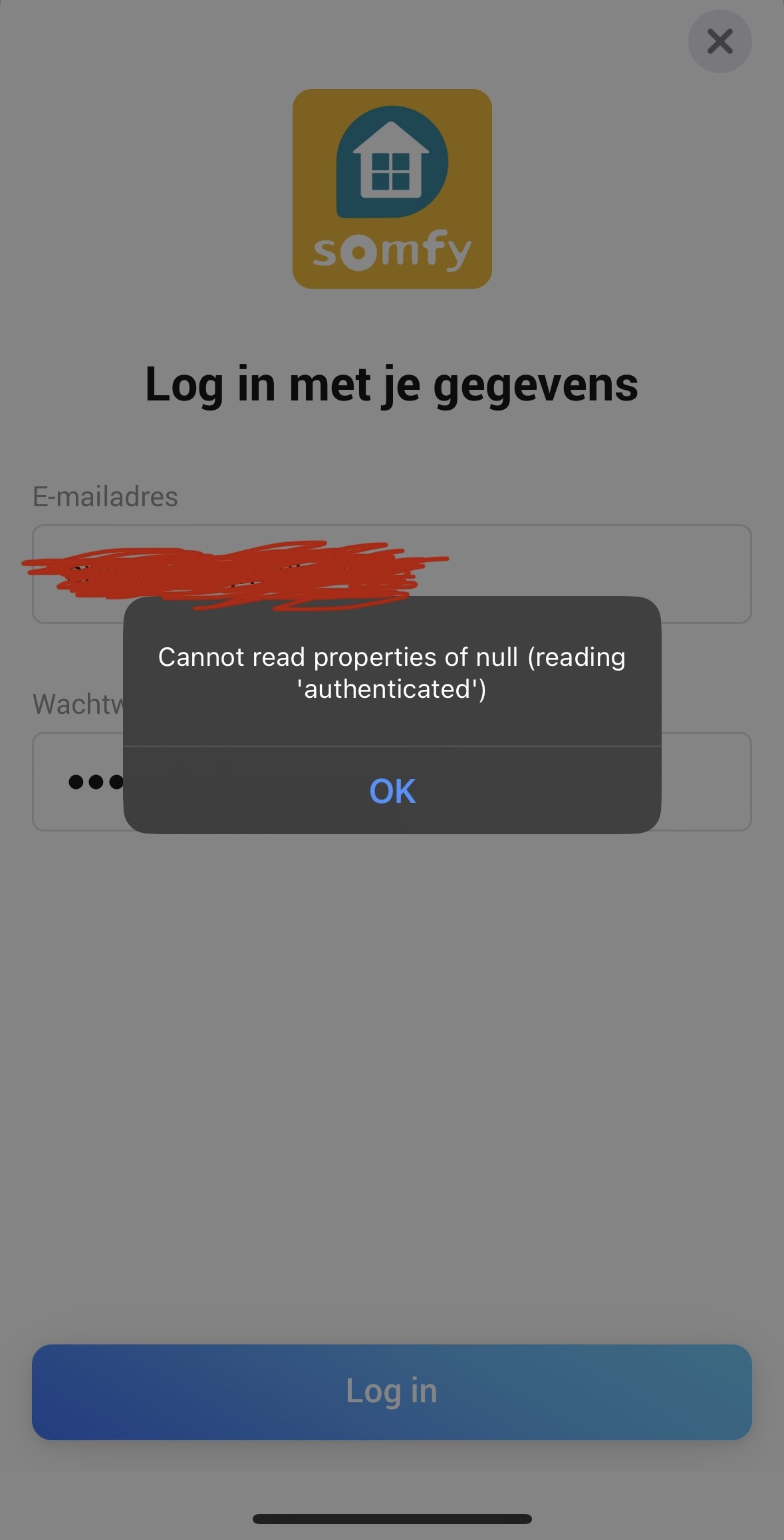

@Adrian_Rockall since yesterday my tahoma connection fails and repairing the connection also seems to fail, any idea what it could be?
I’m not aware of any issues. I presume Homey has an Internet connection?
Could you open the app settings and send the information log.
Logout in the app and then Reboot the app fixed the issue for me, i did change some vlans in my network a few days ago so it could be that my tahoma got a different ip
Thank you for letting me know. Glad it’s working again.
Same issue here some days. SAVE credentials without any change did the trick for me.
