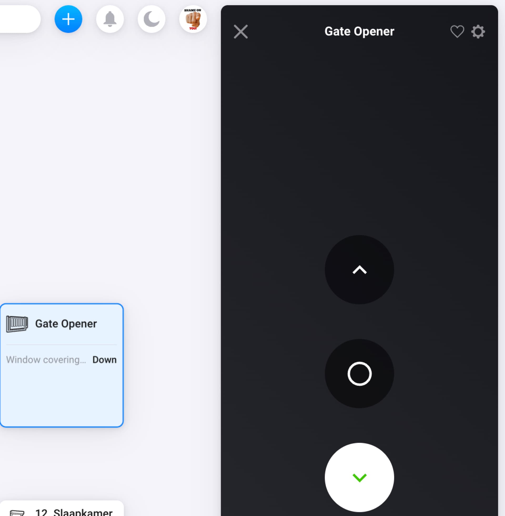

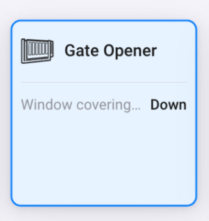

I installed the test. Functionality check tomorrow. First glimp after device install in the app:
The tile of the device shows [windows covering] DOWN / UP, suppose it should be CLOSED / OPENED
The flow card [THE STATE CHANGED] shows UP IDLE DOWN, suppose it should be OPENING / IDLE / CLOSING
For the last, I don’t know what the IDLE state would mean, suppose not moving.
The app uses built in capabilities and that is the closest match.
The idle can also be used to stop the movement.

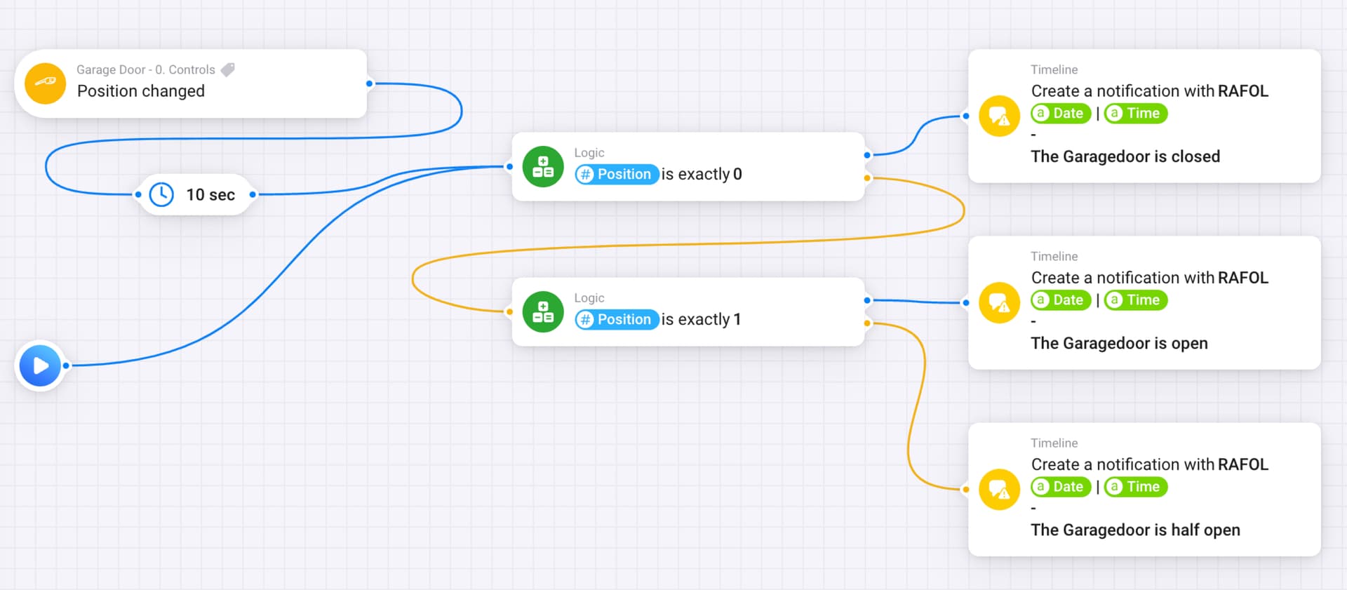

No problem at all, just mentioned it. Last question, is there any chance to read the position, same as the garagedoor, from 0.0 closed to 1 open?
Hmm, I thought that was already there. Can you see the slider to control the position in the Homey device screens?
I don’t think so, the only thing I see is up and idle down functionality, no slider.

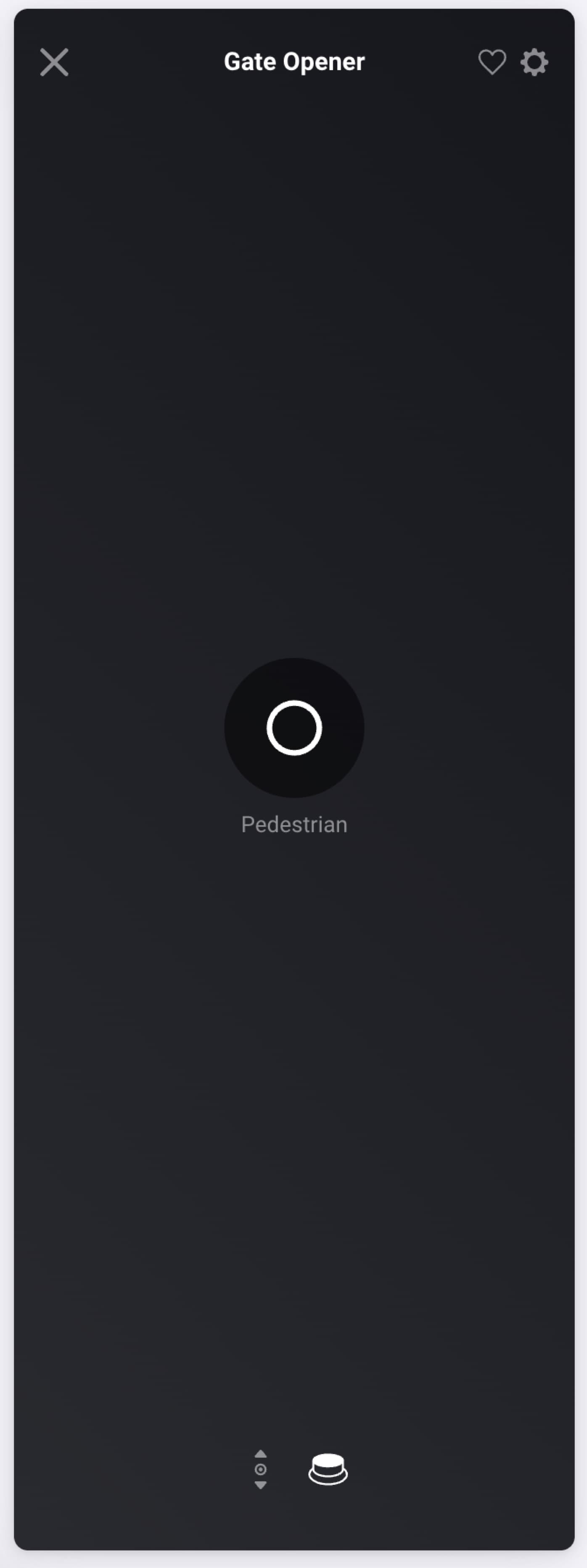

Another thing is the pedestrial switch. In Tahoma when used again, the fence closes.
In the app using the switch and the gate opens in pedestrial position, using the switch again, nothing happens.
Ok, I will check the log again as I thought I saw position information and if it’s there I will add the slider which will enable the Flow cards.
Hopefully, I should be able to do that this evening when I get home.

EDIT: We use pin 60 and 62 of the BFT motor to operate pedestrian position (PED) We will change that later in PED TIMER, closing the gate after xx seconds automatically. You app is required to monitor that movement and positions.
