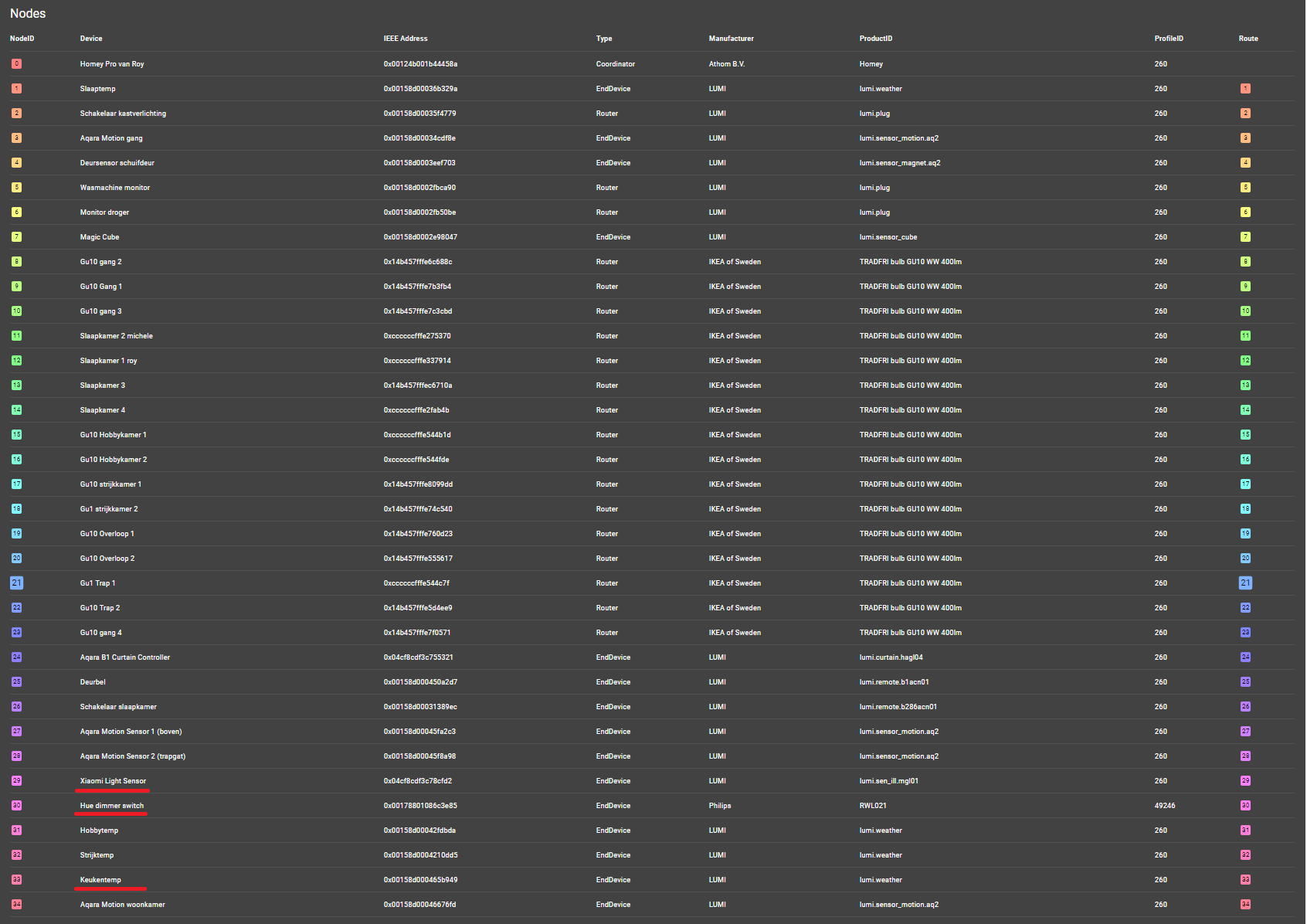

Could you please assist me in what i’m seeing here?
i have marked items in red that are not responding.
I suppose i NEED to reset them in order to get them reconnected right?
restarting homey does not reconnect them as far i ive tried.
Please wait a few minutes and see what is routed and what not. You’ll see more coloured squares/numbers right to the last column if you wait a bit.
Pls post a screenshot of what you see there…
You should see this if you wait a few minutes (to give you an idea). Please check if the Current Command below this table says generateMap. If it doesn’t, refresh the page.

please see below.
I see for example the not functioning Hue Dimmer routed through a GU10 ceiling spot.
but still, the unit is not working. Same applies for Xiaomi light sensor and kitchen temperature (aqara as well).

I can see that numbers 5 and 6 are disconnected. Those are routers. I would suggest reconnecting them first. I can see the are smart plugs, are they unplugged / lost power?
When they are simply turned off, they should still act as a router.
After you readded the smart plugs, you can add the dimmer individually (by deleting the device and adding it again). Possibly the smart plugs that are disconnected are the problem. However, it’s also possible there is a problem with the ceiling spot. It should always have power.
Note that it might take some time before a device that is unavailable in Homey, is shown without routing in the table. I personally have had good experience with working out how the signals need to pass through walls to get to the devices. If the ceiling spot is close to Homey, but the signal has to pass through walls, this can be a problem. Adding a router in a strategic place can make all the difference (at least, it worked for me). It’s not just the number of walls that count, it also depends on the material, thickness and angle of the signal (in my limited experience). One sensor gave me problems a while back. I solved it by adding a router on the other side of the wall. The distance was roughly the same and it still had the same (one) wall to pass through, but since the angle was 90 degrees, the signal has a shorter distance in the wall, so it worked.
