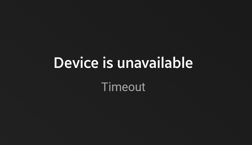

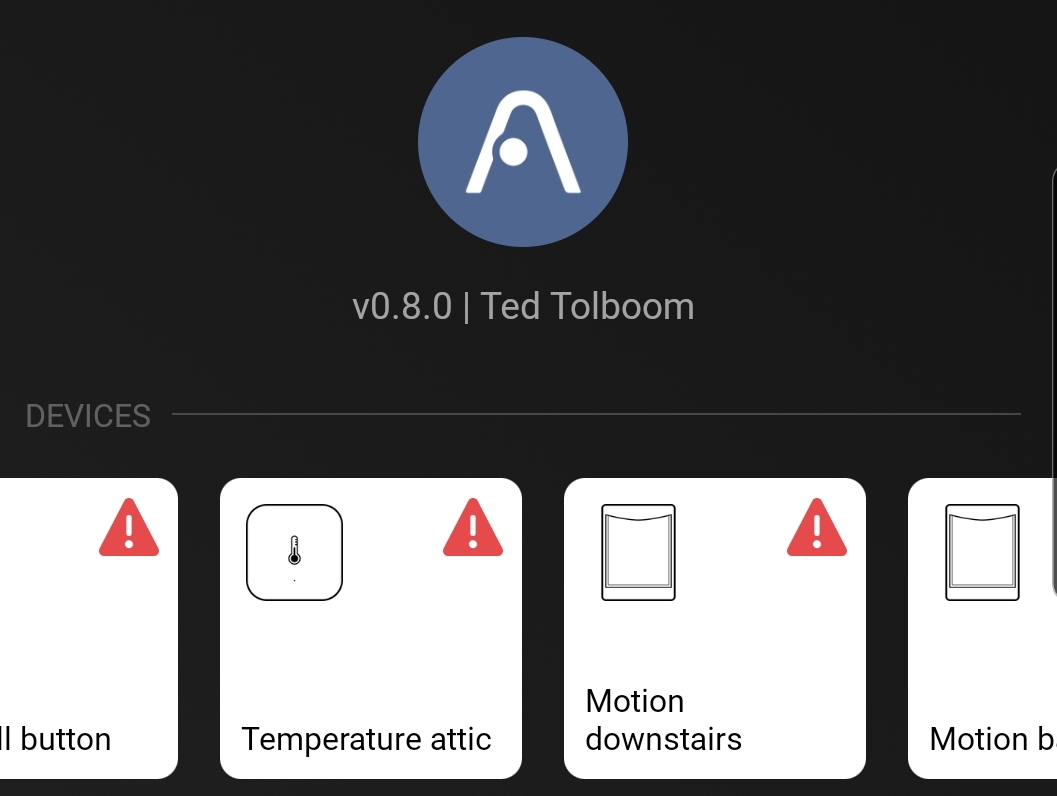

Hi @TedTolboom, can you please take a look on 4ad8449f-6d98-498c-8114-60b492ec2f9b ? It’s happening approx. in 1 out of 5 regular reboots of Homey… App restart don’t help - all devices are unreachable while other ZigBee devices work :frowning: All devices linked with the App are reporting Timeout. This issue looks connected with v4 of firmware.
I have seen it can take up to 4 hours before all zigbee devices are connected again after reboot, patience my friend and welcome to the world of Athom and zigbee… :exploding_head::exploding_head::face_with_symbols_over_mouth::face_with_symbols_over_mouth:
Since the before last Homey update all my nodes came back. So happy.
Just now I updated to the last Homey firmware and again all Aqara nodes have a time out.
Is there anything I can do to avoid this?
Wait.
Yes: wait until they are up again and never reboot again after that :stuck_out_tongue: :innocent:
This was about an update?
But when I reboot at 04:30, check the nodes at 07:00, I still have to wait? Until when? Sint Jutemuts? :grin:
It happens a lot that after a firmware update, Homey has problems with Zigbee. It usually fixes itself after some time. Perhaps take Homey off power completely for some time.
