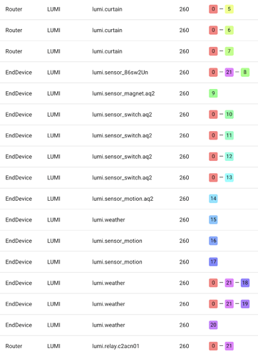

The representation of the zigbee mesh in the developers section, shows that only 1 of my Aqara devices (a relay as node 21) act as a router. That is strange, as I have 3 more Aqara routers (node 5, 6 and 7). These seem to be avoided

To answer your question: it’s not app-related. A Zigbee controller (like Homey) doesn’t have a lot to say on how a mesh should form, and the issue is that (AFAIK) Zigbee doesn’t have a feature where a controller can tell a device that it should connect through a router because the controller’s device table has already filled up.
My experience with Aqara sensors is that they prefer to connect to the router that they connected with during the pairing process. If that is Homey, they may prefer Homey instead of a (closer-by) router device.
