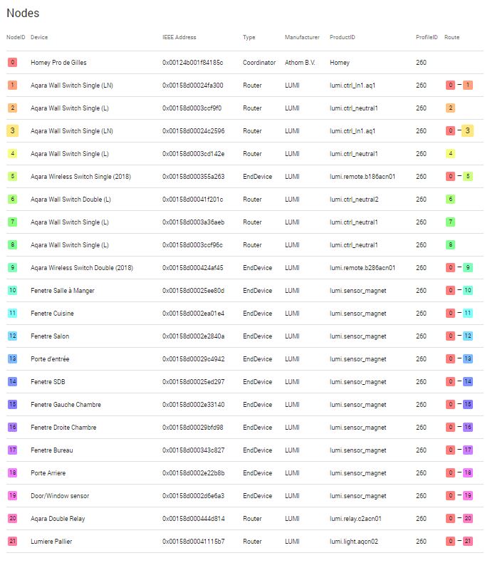

Hello, I just tested to remove the material on battery and then save them “Paste” to a switch which makes “Router” and the material registers well but my network graph remains always the same, the routers are not used
That network graph isn’t complete, you can see various devices being router “through” themselves only. It can sometimes take a while before the correct graph is being shown.
Okay, I’m going to wait a little longer but it seems to me that it doesn’t move even after 15 minutes

I removed all the switches without neutral and some sensors on battery.
I restarted Homey and I associated sensors on battery right next to a router, but they still do not hang on it.
I have same issue. One of devices is not showing the route to Homey. No matter how long I do wait, also after restart of Homey. However it works without problems.

Hi, I’m facing a couple of zigbee problems. Every time I update my homey it gets worse and now 1 of my wall mounted switches don’t work anymore
Also my zigbee netwerk doesn’t want to use routers. So I’m thinking, what if I connect all my aqara switches and sensors to a aqara gateway and let my homey communicate with my switches and sensors thru that gateway, the same way my milights and somfy devices work.
But the gateway is not supported by this app? Is there a way to do this and will that help to make my homey more reliable?
I have no experience with the hub, but are you exactly sure that it doesnt route? You need to let the developer pages stay for quite a while to be able to see the actual routing.
Also, each time you add a new device, and if you do it close to homey my experience is that it will stay connected to homey and not any router. Connecting them close to any of the closest router helps.
