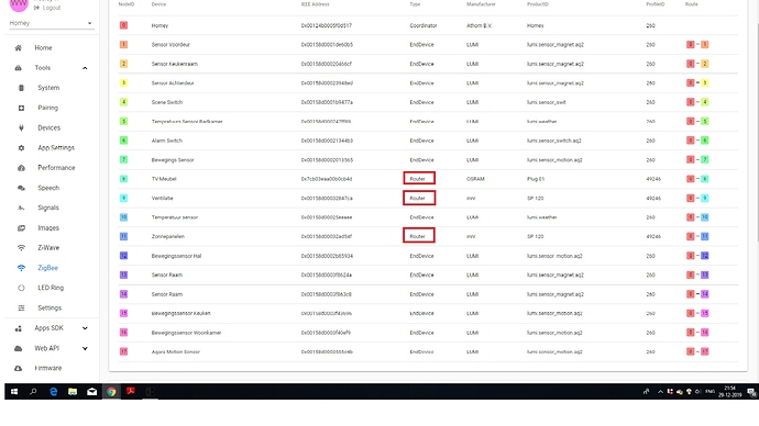

Mmh … It explains my issue !
I’ll buy an Ikea bulb tomorrow to extend my network.
I let you know if you want.
Thanks !

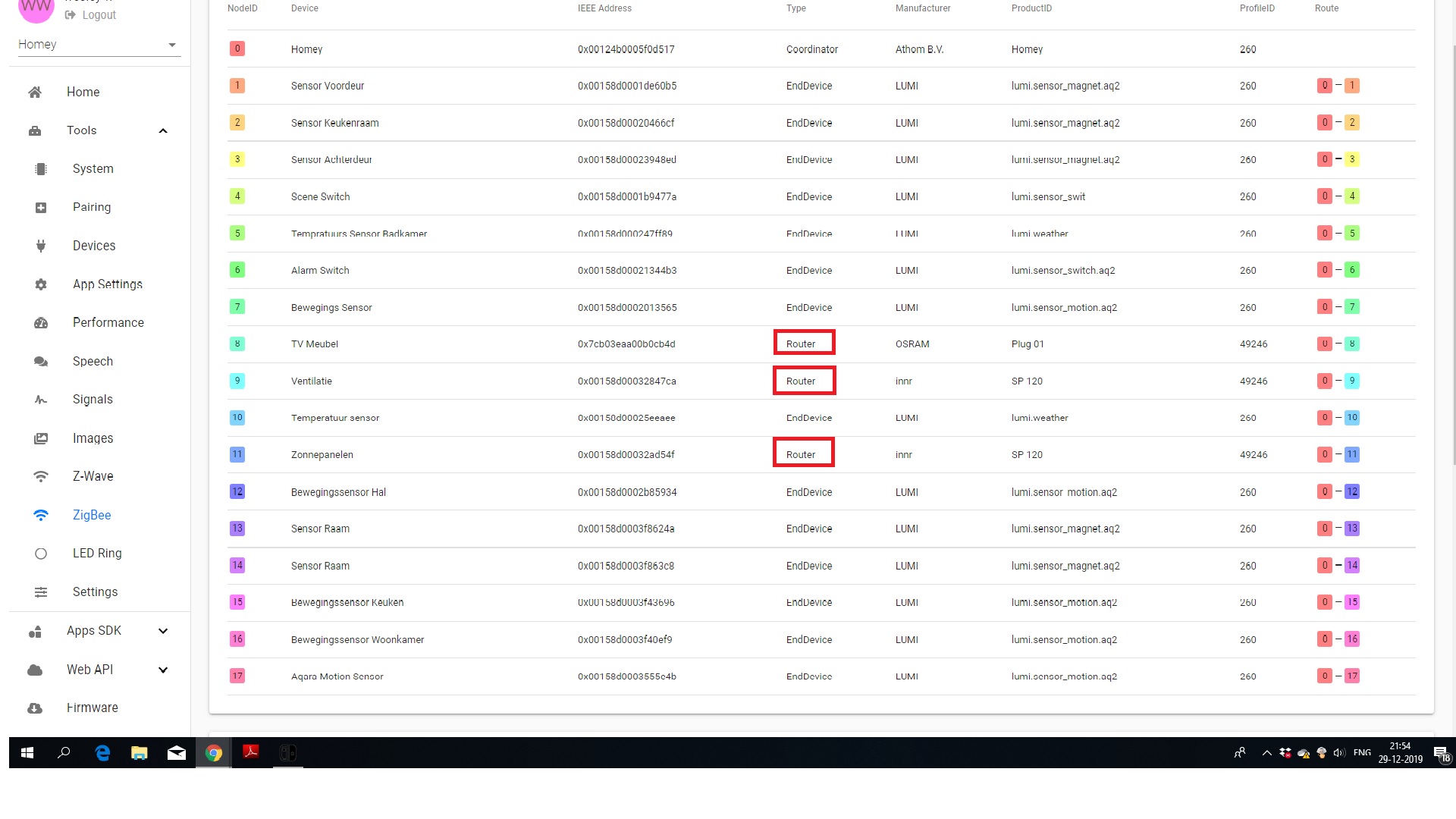

And did it do the trick? I do not have a mesh also and i’m curious how i can make this work for me
The page doesn’t show the mesh, it shows the routes devices take…
And it takes some minutes after opening the pages until the routes are shown (in opposite to the Z-Wave page, that shows the routes immediately)

I did :
  • reset zigbee network
  • uninstall Xiaomi Zigbee app
  • add Ikea bulb (x3)
  • add Ikea repeater (x1)
  • add Ikea control outlet (x1)
  • install Xiaomi Zigbee app
  • add all my Xiaomi/Aqara devices
=> it works perfectly, and I see the Zigbee route correctly.
So, I think several router devices don’t route the zigbee network.
