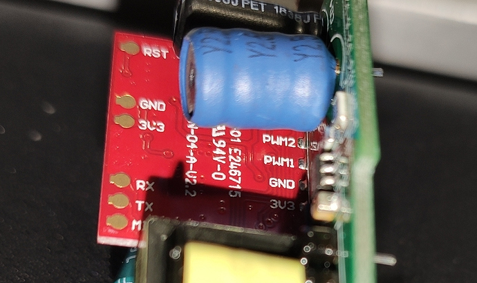

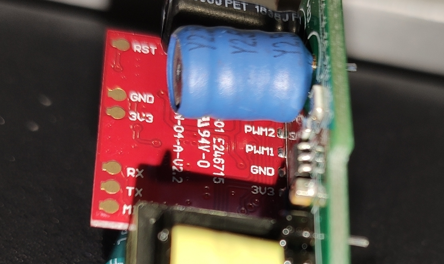

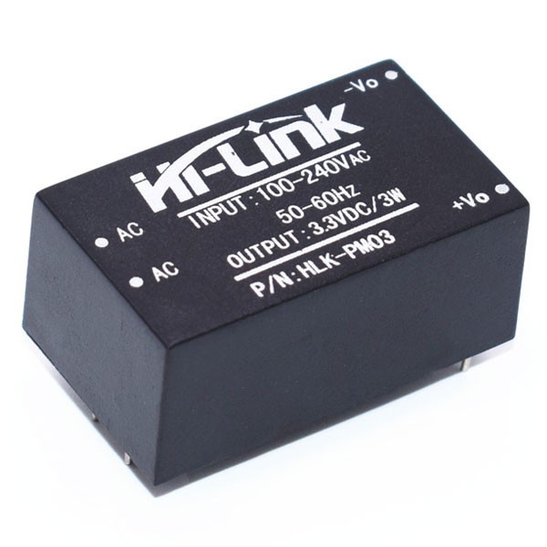

I want to convert 2 aqara bulbs into zigbee repeaters (routers), has anyone tried to connect only the controller power to see if it works? (without conecting PWM1 and PWM2, power management?)If it works it is not a bad idea to put it in the junction boxes with a 220v> 3.3v transformer.
I answer: it works.
I just need to buy the mini transformers.

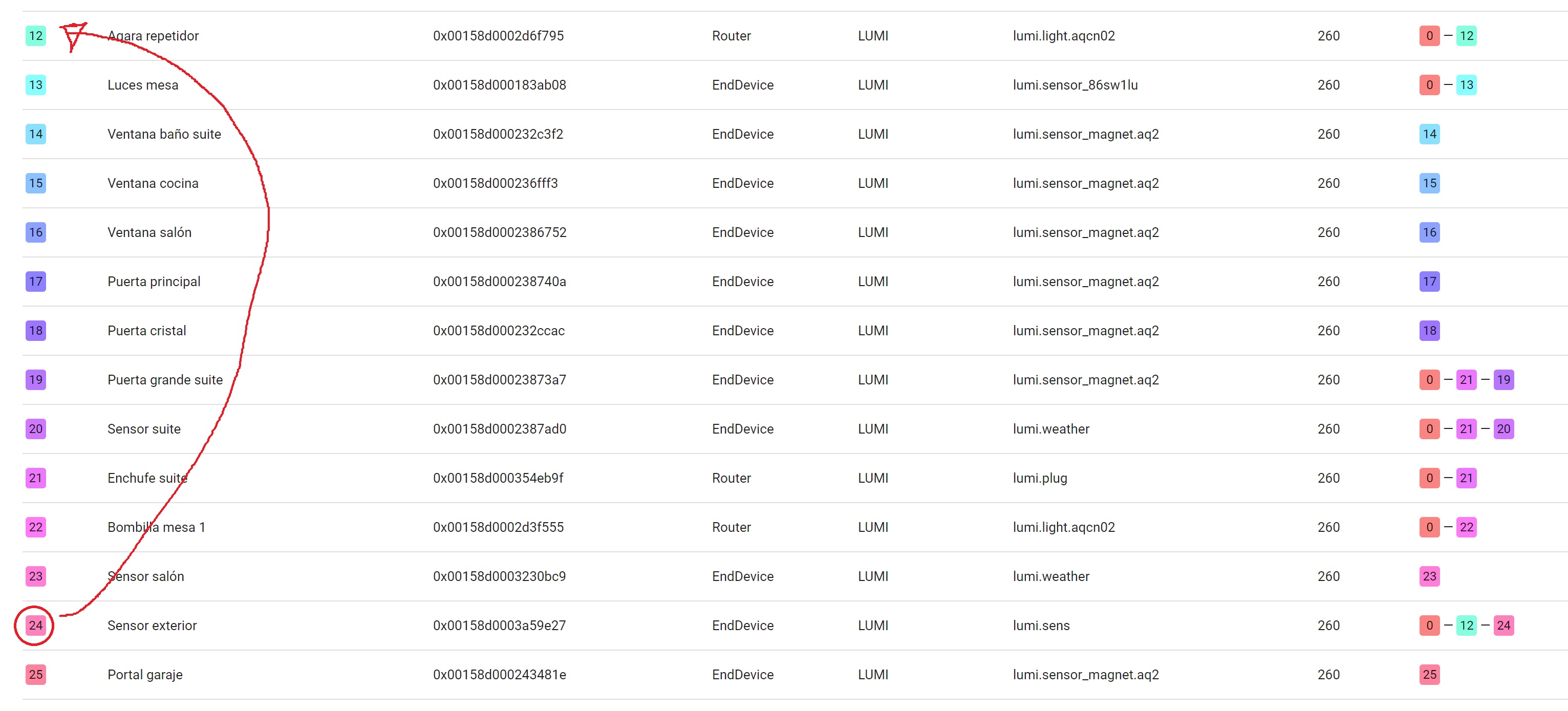

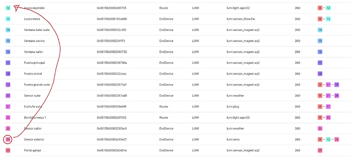

I’m using Homey with this app, to manage several devices Xiaomi.
My Zigbee network is composed of Xiaomi/Aqara devices only (end devices and routers).
Recently I bought a new Aqara wall switch wireless, and different sensors etc.
But, I can’t add them because the app still waiting inclusion of the device (and sometimes an error appears : “An error has occured” => time out ?).
I’ve tried with several devices, to be sure it isn’t due to the switch …
I restarted the app, Homey, I still have the problem.
I tried a PTP (25 minutes), the same.
So, i deleted an old sensor and tried to reconnect it : impossible too :frowning:
You can find below the screenshot of my Zigbee network.
So, I have questions :
  • why all my devices are directly connected to the Homey, and not to the routers ?
  • do you think a zigbee reset can solve my issue ? if I connect routers first maybe ?
  • how can i connect my new devices ? Is this issue known ? Or is due to the limit number of Zigbee devices ?
Thanks a lot !
Regards
PS : sorry for my english
    You probably have to wait 10 minutes before the webpage shows the routing of the devices.
    No
    Try again, with some devices it helps if you keep pressing the pair button on the device every 3 seconds ( so long press to activate pairing, after pairing starts give the button a short press every 3 seconds until device is included)

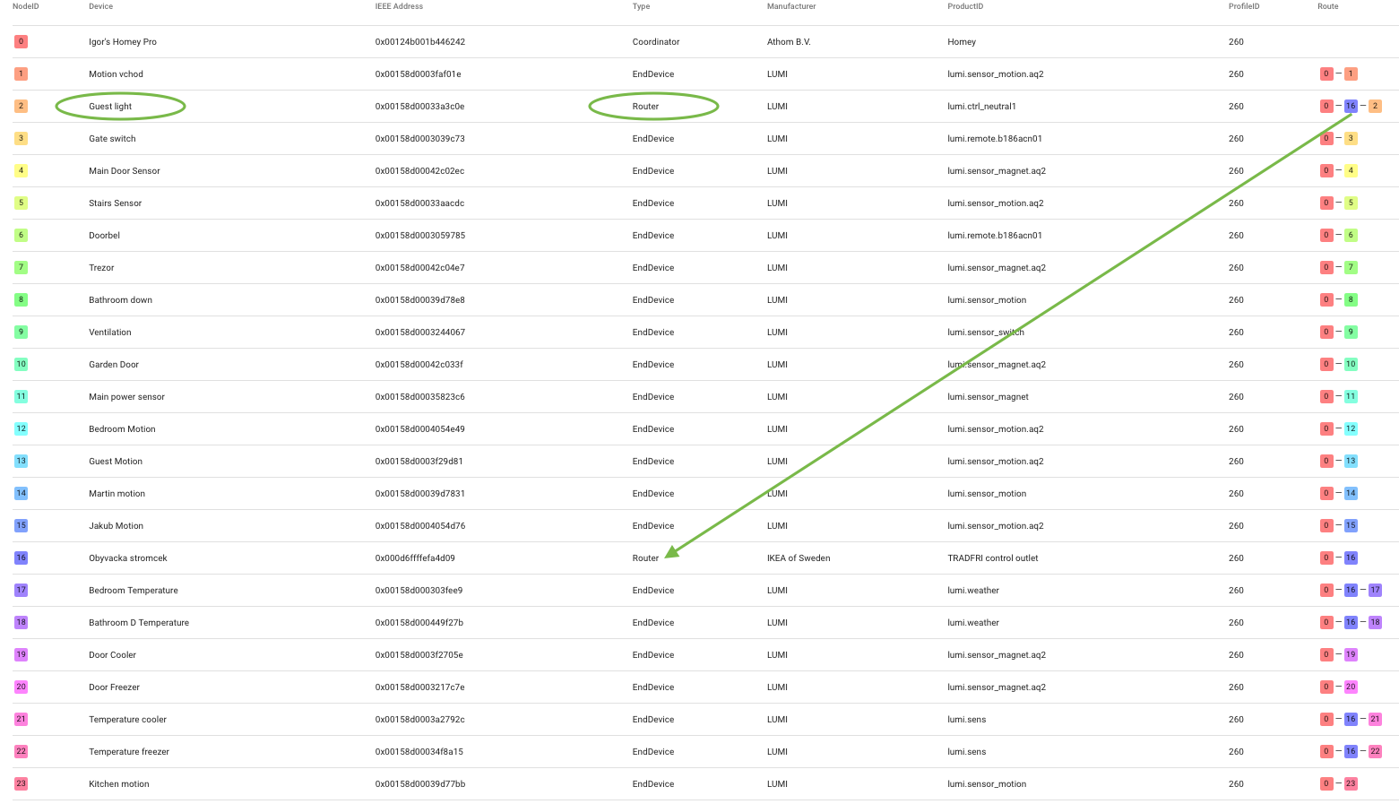

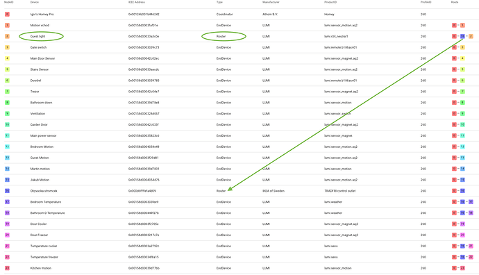

I noticed, that even when Aqara switch is marked as a router, it never works like that. I reached Homey zigbee limit and had this Aqara switch installed as one of the first device, but it didn’t route. I wasn’t able to add another zigbee device. Zigbee reset didn’t help. Then I added Ikea plug into system and it solved new device issue. What is interesting, that Aqara switch (router) is being routed over Ikea plug (another router) and then to Homey. But Aqara is not routing anything.
