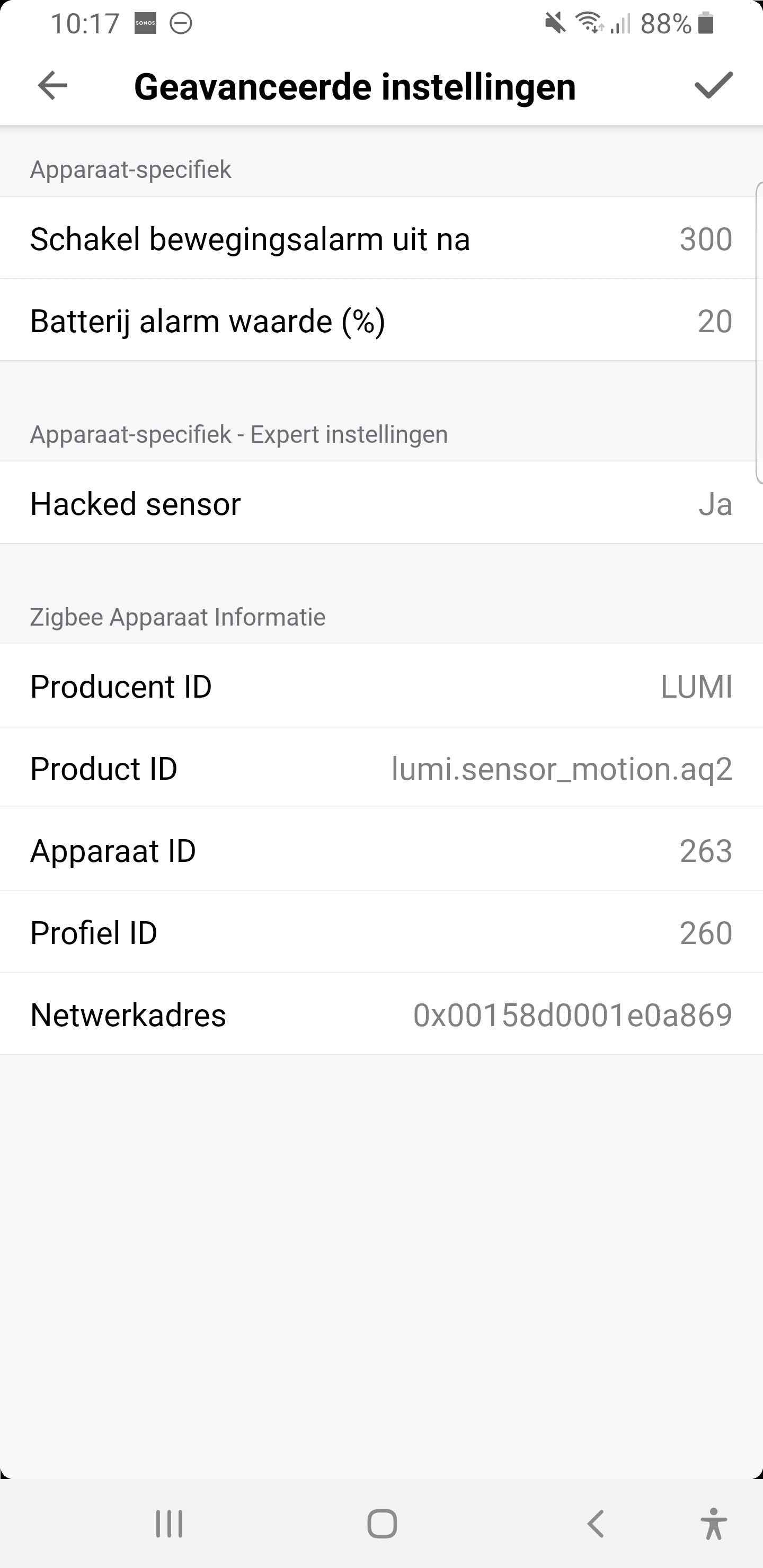

When i look in advanced settings i can only change “Schakel bewegingsalarm uit na” to a minimum of 60 seconds. When i take a lower value then 60 the app not accept it.

Using app version 0.6.2
Sorry for the Dutch screenshots…
Wauw, i think i have to update the app. Thanks for your replay :grinning:
YESSSSS, It works… I’m happy :innocent:

Have you set, in advanced settings, "hacked sensor"to yes? I have now modifide 4 sensors and work all great.
