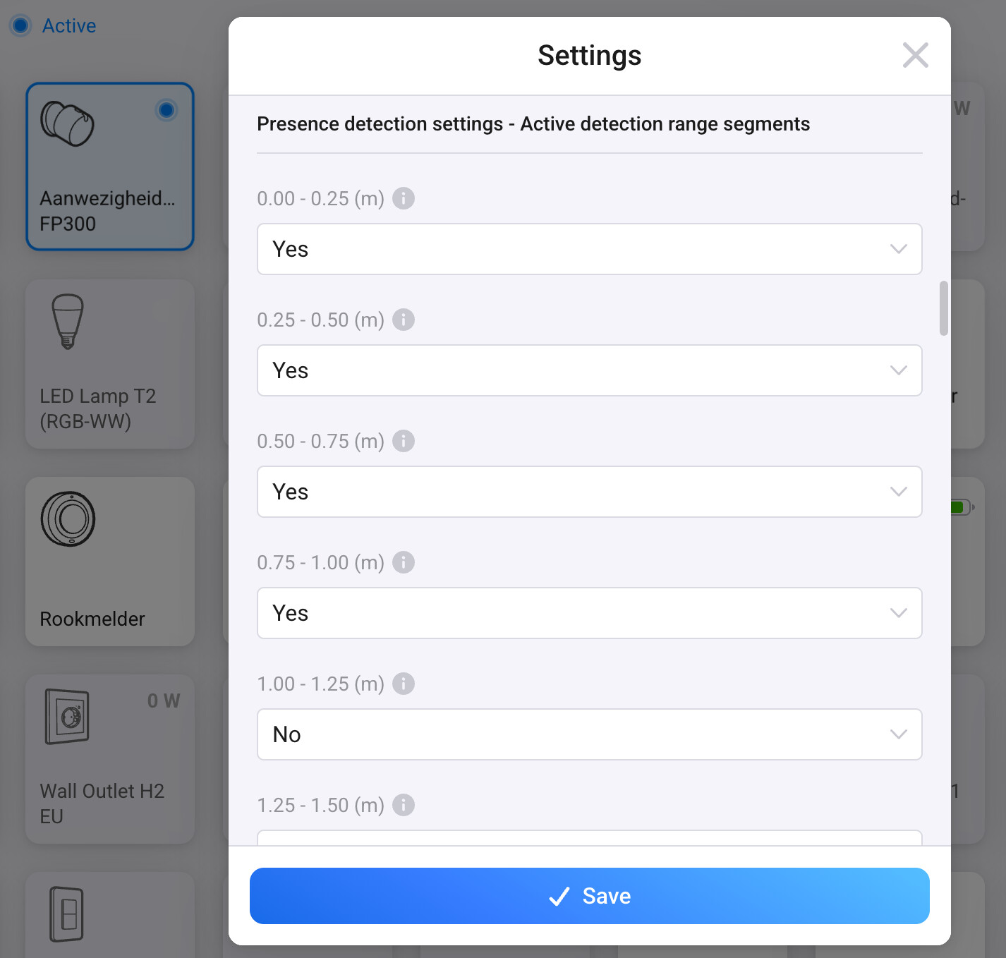

@ermethic @Maurits In this version I fixed (read extended) the Aqara FP300 Presence sensor - presence (mmWave) sensor detection range. The settings now allow to activate or deactivate any 0.25 m segment in the sensors detection range (0 - 6 m) to trigger the presence alarm.
The motion PIR will keep triggering independently of the range set.
In above example, I only activated the segments in the 0 - 1m range and placed the sensor at the back of my working desk. When entering the room, the motion sensor is activated, switching on the room lighting. When I sit down behind my desk, the presence alarm is activated turning on the desk light and music.
Thanks this works smooth!
Thanks for the great work!
