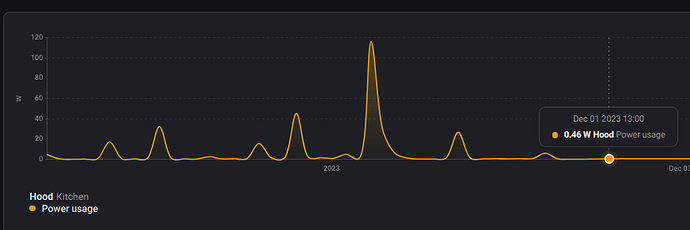

I confirm - but I was the one even updating firmware but it was working fine until some specific Homey update - this is what I told also to Homey support to kind of exclude their thoughts on the OTA firmware update. I even bought recently new one and - no data about power consumption.
…and even without reconfiguration, it stops working
In my case, plug stopped reporting data around / on 1.12. :
