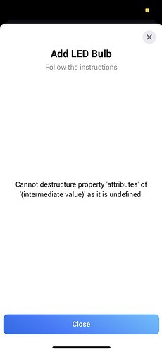

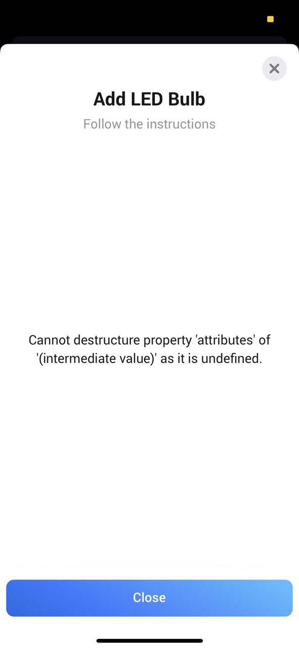

Today I tried to connect a zigbee lamp Aqara LED Bulb T1 to my Homey pro 2023
but without success. I always got an error message like in the screenshot. Has anyone been able to connect?
Thank you!
I am having exactly the same problem.
It was working fine on my HP2019, but after migrating to HP2023 I am getting this.
I also had a massive issue with repairing my Aqara devices after the migration. I ended up having to delete them all and add again.
Please report to Athom, this is most probably issue of Zigbee stack implementation on Homey.

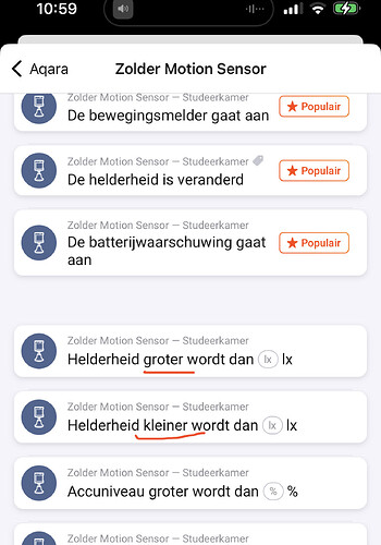

This is what is see under app settings while creating flow.
It looks like it will only work if it’s increasing or decreasing i a certain period of time. If lux decreased 30 minutes ago my flow won’t trigger.
That’s why is thought aqara app might be the problem because you can’t set the then option for example to check if lux is under certain level. Seems if decrease and increase is not in progress nothing happens.
What is need is a simple option under “and” part of the flow. Something like “ when lux is 30 or lower” , or “30 or higher”.
