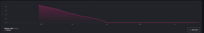

I’ve installed 4 Aqara roller shade drivers (E1) and they are working great! Strange is that one of them is updating the battery info very frequently (during charge I see an update every few minutes). But the other 3 do not give any updates. Even after repairing/ removing and adding the device again, etc. Is there something I can do to get the battery info from the other 3?
Thanks again for any help!
I would be keen as well, even I have only one, it’s stuck on same battery level for 3 months. already. despite I charged it in the meantime…

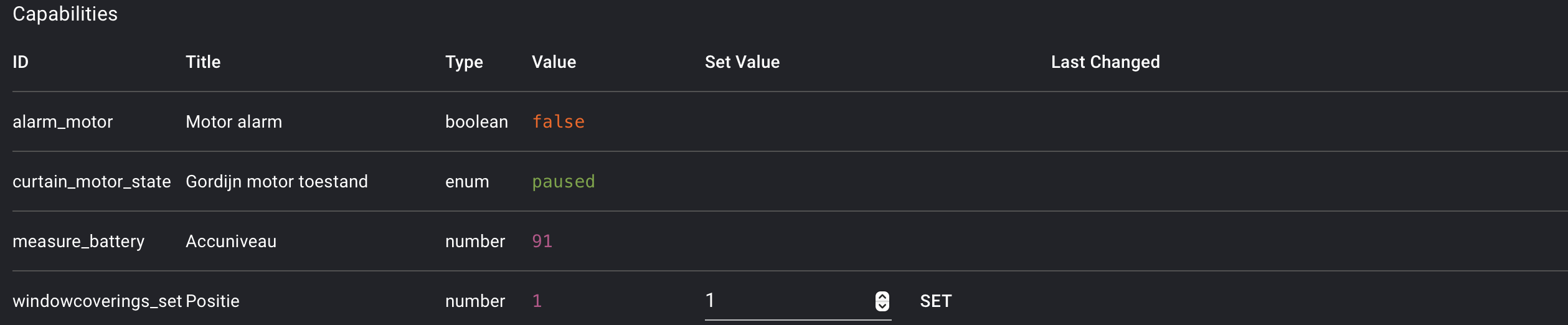

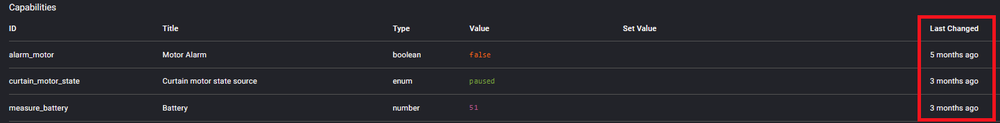

Some more info:
3 of the four shows this in the dev view:
One of them has them all:
Maybe that there is an easy way to get/receive/trigger the other 3 parameters?
Maybe an idea to check the device (dev) screen and see if/what there is? In my case 3 of 4 shows only ā€˜null’
I believe null means that data for given attribute were never processed by Zigbee daemon and stored into SQLITE DB… the question is why that happened. My guess is that it’s not app fault and that’s why also TED is soooo long silent in this thread. Another guess - waiting for Athom to fix their stuff first but maybe I’m wrong.
