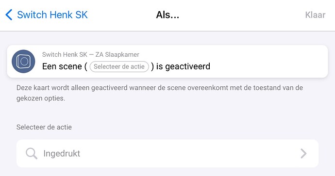

I have a problem with my Wireless Switch (2018). Could be since I updatet my HP23 to rc110, but not sure yet:
Flows where a scene (doubleclick) was selected as trigger did not run.
When the flow was inspected, the IF card was broken.
I tried removing and adding the switch again. In that case I can select an IF card “when a scene was activated”, but I cannot select which scene.
Is this a Homey rc110 problem or can something else be wrong?
Anyone else experiencing the same problem?

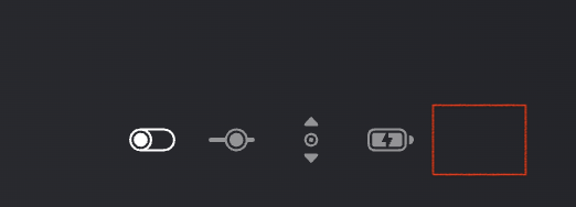

@TedTolboom I’ve this Aqara B1 Curtain, is it possible to add a ‘Timeline’ tab (feature request) to the apps.
