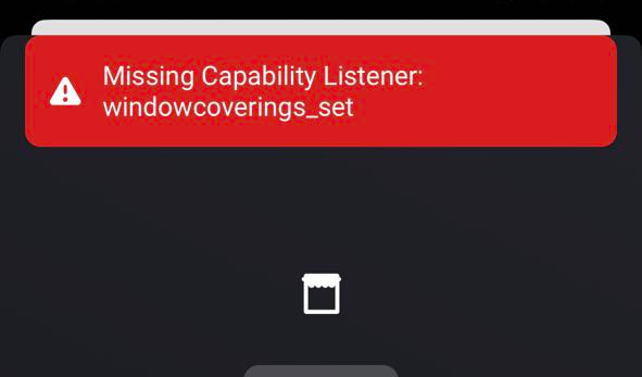

Hi @TedTolboom ,
I just added the Roller Shade Driver E1. But when I try it it doesn’t do anything and shows the error:
Missing Capability Listener: windowcoverings_set
afbeelding
I’ve added a debug report: e847b64c-eb36-4dcd-a478-bcaea5792b0e
Aqara app 1.7.1 - Homey Pro 2023
Any idea what is wrong?
