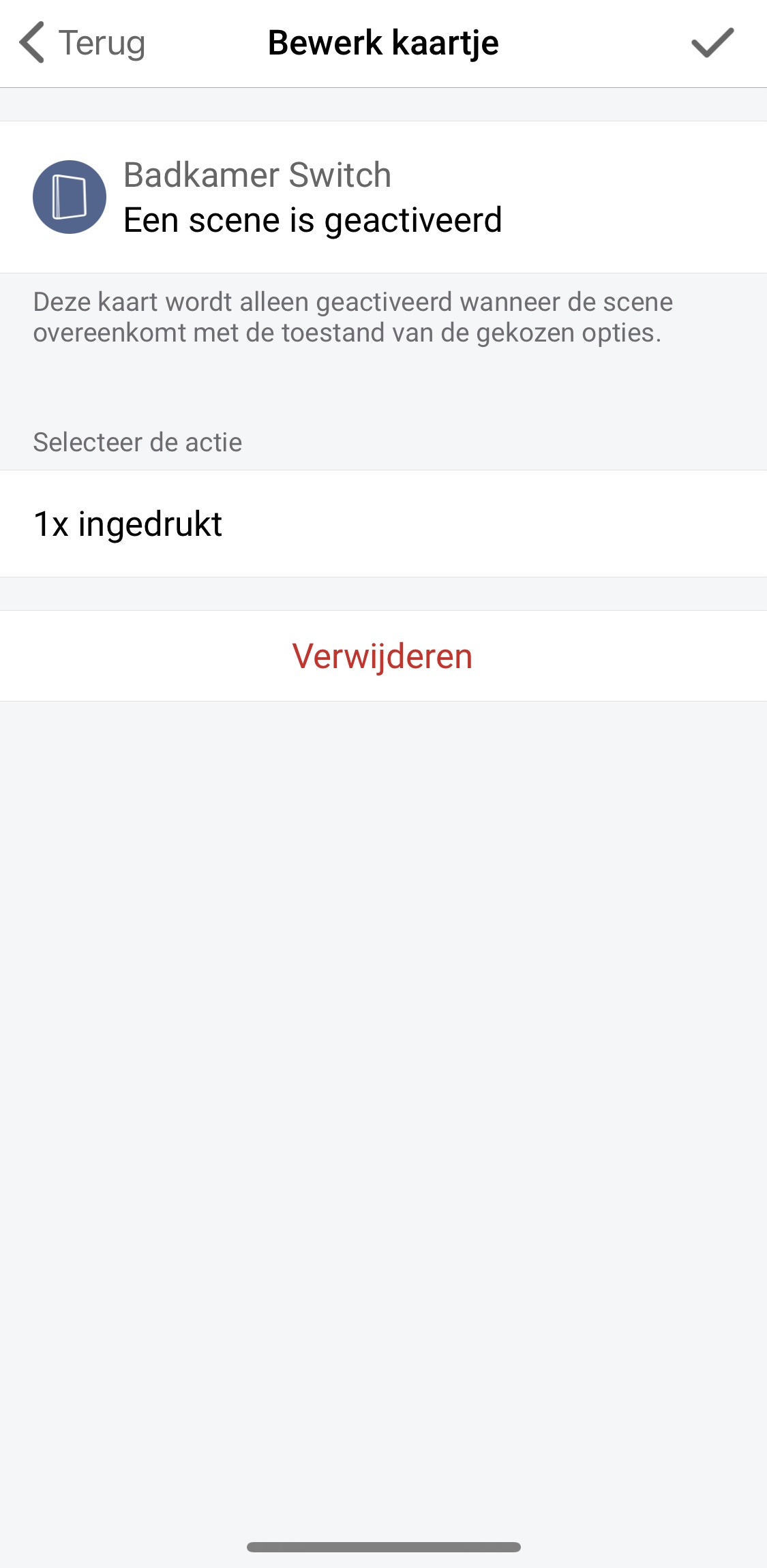

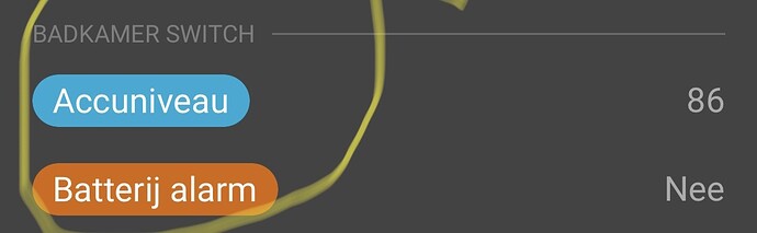

I have bought a couple of aqara wxkg03LM switches (wireless single rocker switches) and it seems that I can’t get it to function with double press or long press. I only get the one press to work. I have tried via scene activated and button pressed. Via scene activated I can get the 1 press working, but when I try via button pressed and use logic to select 2x pressed I only get ‘Accuniveau’ and ‘Batterij alarm’.
What am I doing wrong?
Hope to get some help, thanks guys!
There are two version of that device, the older one identifies as lumi.sensor_86sw1lu or lumi.sensor_86sw1, the newer one as lumi.remote.b186acn01.
According to this page, the latter supports double click and hold, the former only supports single click.
I don’t know if the Homey app supports double/hold for the newer version, but if your devices are the old version, that’ll be the reason why you can only select “1x ingedrukt”.
Thanks, that seems to be the problem. I have the 2016 versions :frowning:
