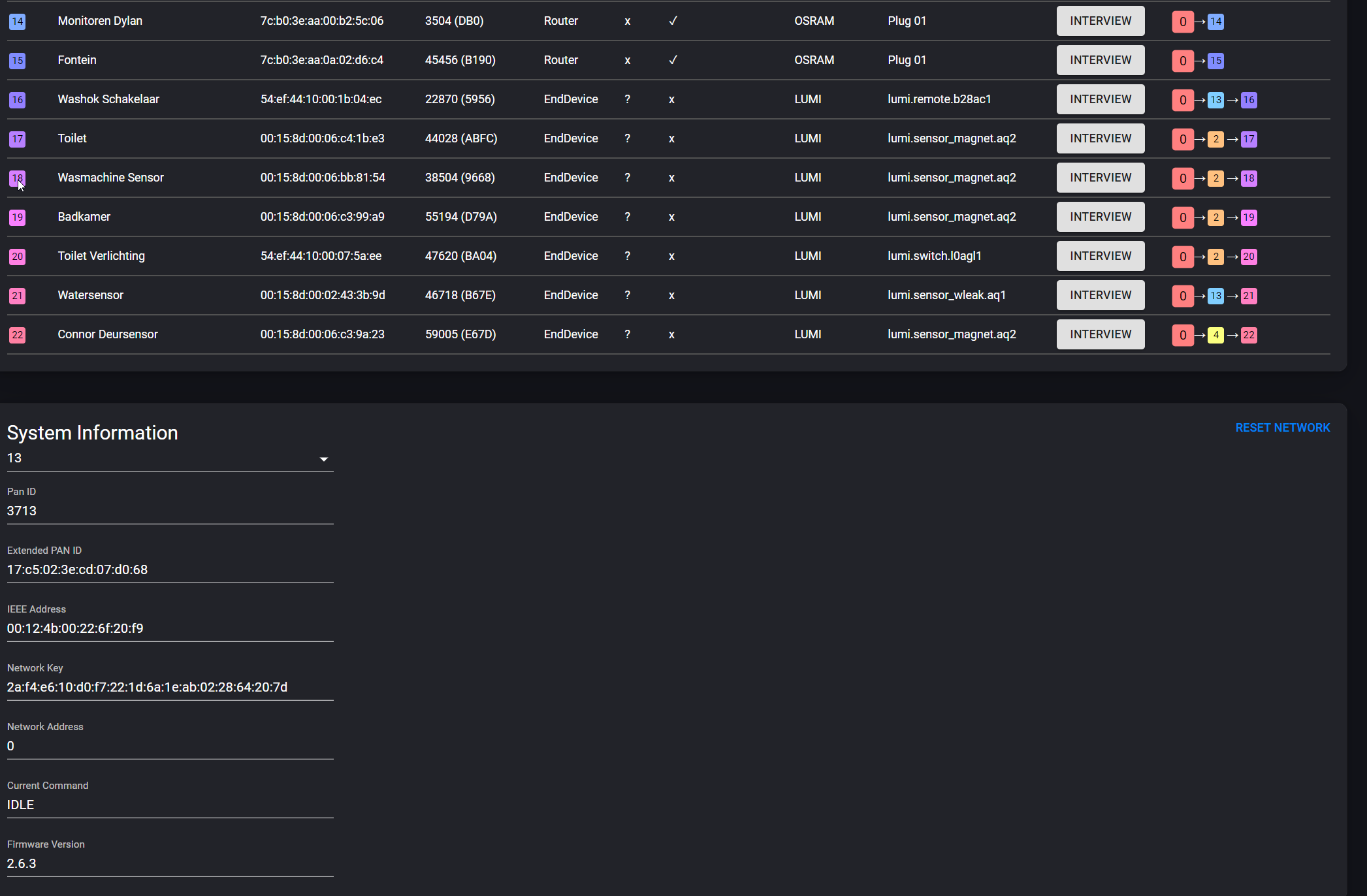

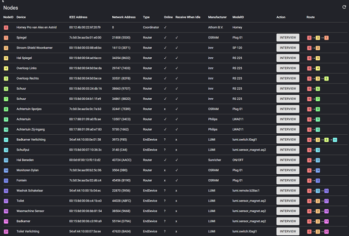

I keep having problems with Aqara devices that suddenly stop working.
With my Aqara door sensors, only removing and adding again works. Haven’t seen removing the battery and putting it back in work yet.
I have placed two Aqara T1 switches behind my light switches and these also regularly go out. I can then still operate the light with the light switch, but it no longer comes on via the Aqara sensor on the door.
I also usually have to remove this in Homey and add it again to get it working again. Because that is a little more work than adding a sensor again, it takes a few days and it may suddenly work again.
I have several devices from different brands and experience this kind of problem only with Aqara devices and I am about to replace all these Aqara devices for a brand that works stable.
Before I do, I would like to ask the expert users here why this is only with Aqara devices.
Is it the app, is it Homey, is it something else?
I have connected my Zigbee devices as much as possible on Router and then End devices.
Homey is in a fixed location, but testing with Homey in another location also did not yield any improvement.
Zigbee channels and WiFi channels are aligned so that they do not interfere with each other.
Zigbee channel is on 13 (this is because my Zigbee network that was on channel 11 then stopped working one day and a reset was the only option to get it working again)
Wifi channels are available via 4 access points of TP Link (EAP 245 and 225) on 8, 9, 10 and 11
If anyone has an idea what I could try, I’d love to hear it.
