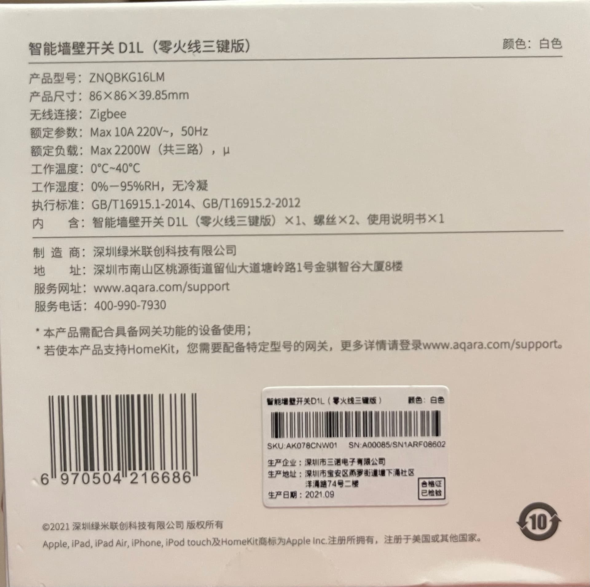

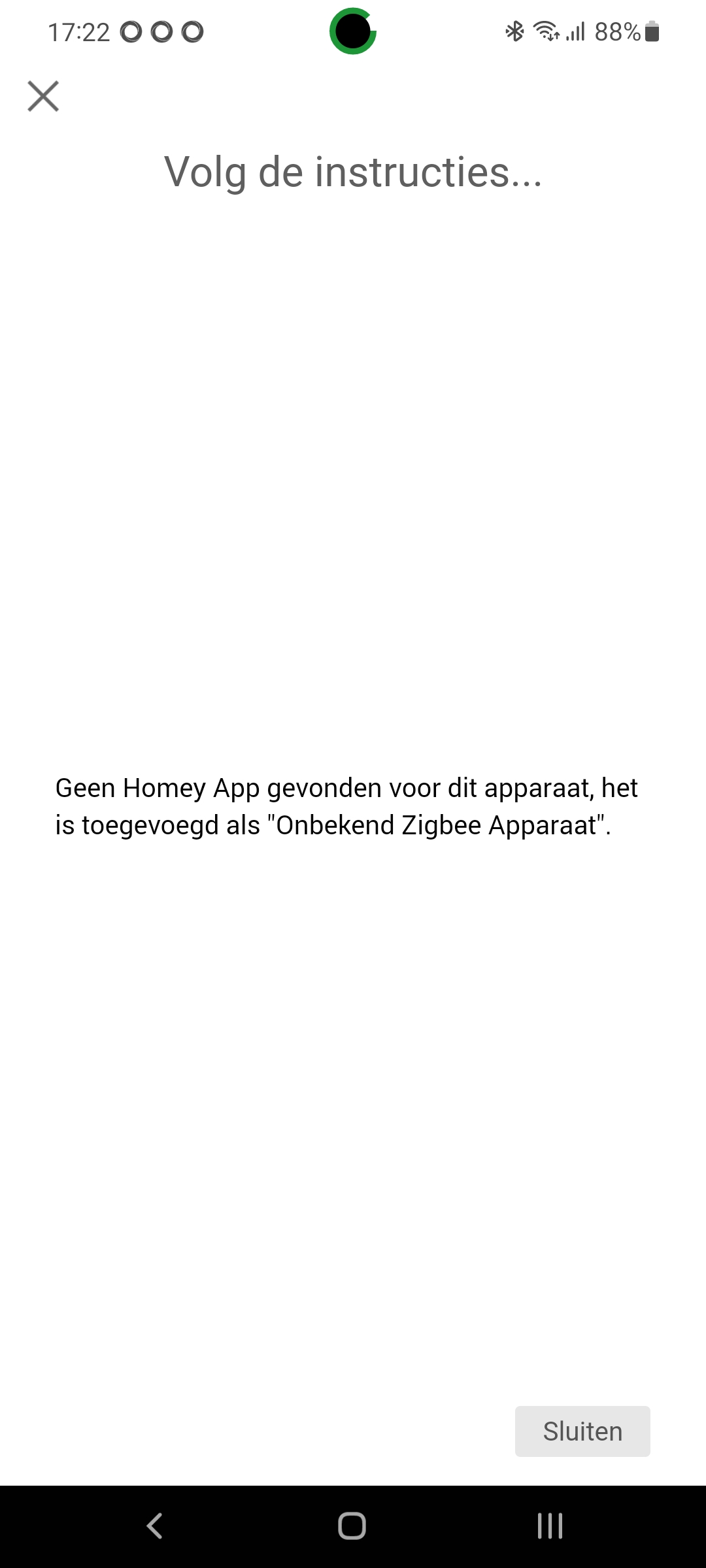

Hi @TedTolboom, I have an issue whereby I’m unable to add the Aqara D1 Wall Switch Triple (LN). It keeps showing the error “Something went wrong when adding the device, please try again”. This issue didn’t happen when I added Single or Double rockers.
I had also tried adding it as a generic zigbee device in homey and it was able to capture the left switch.
The model which I received seems different. Its model ID is ZNQBKG16LM, while the EAN is 6970504216686. It also says D1L instead of D1.
The app report ID is 9a47985e-a616-4936-af27-e6b93f92d2c0
NEW UPDATE: I interviewed the device and below is the device interview json.

I experienced the exact same issue when adding new D1 switch.
I have around 20x D1 switches that I am having trouble establishing connection.
Following this thread with great interest.

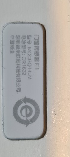

I purchased a while ago 2 extra aqara door sensors, i already have several of them in use.
Today i wanted to add 1 off them but it fails.
It is added as ‘unknown zigbee device’ or not at all.
I tried the second one and with that sensor i had the same result.
(i am running app TEST/experimental v1.4.1)
This is the info of advanced settings:
This is the label on the back of the device:
Is this a known bug or something or did i received the wrongs door sensors?
Currently i have 27 zigbee devices add, from those 27 2 of them are routers.
I do not have any zigbee ‘issues’ ar reported many times in these forums, everything seems to be working fine, except that i cannot add these 2 sensors.
Does anyone have an idea what this can be?
Here’s an idea: search for that model number (MCCQG14LM) on the forum, and you’ll find various posts about it. Like this one asking for support and this one where @TedTolboom answers that question.
ok thx.
Conslusion: i can throw them in the bin
