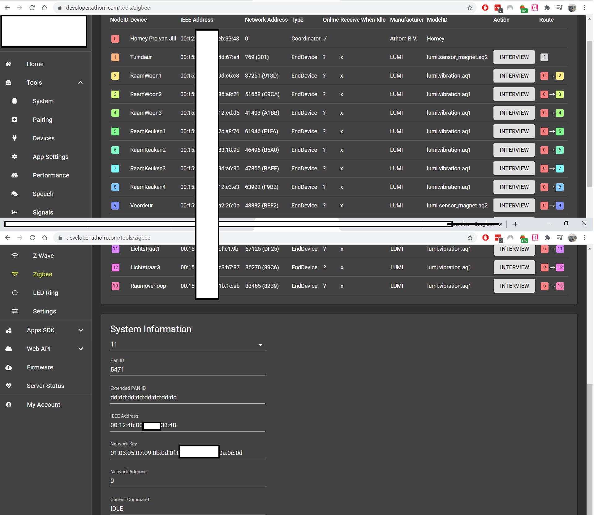

I have a strange problem with the vibration sensors.
I bought 14 for an alarm system.
Now the first 11 have just been added, (with the trick of not letting them go to sleep too early) but the last three just won’t add. I also do not see the screen that homey has found something.
Now I have tried them on my homey at home and he will find them there immediately.
I only have battery powered zigbee devices.
This is the screen shot from devtools.
Does anyone see anything strange?`
Edit: Oh did ah PTP for 10 mins but did not solve my problem.
Using only battery powered devices is asking for problems, it is recommended to add routers (mains powered devices) first and then the battery powered devices (if you only use battery powered devices you are limited to i think 20 or 25 devices). The second problem is that you don’t get meshing and devices you linked to homey and then place in different places in your house lose connection. If you really want a stable zigbee network do it as i stated and you can have “unlimited” devices (i have 60+ now).
